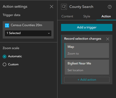

We'll start making our changes in the Search Widget. In the Action Tab, I have added a Open Sidebar Action to my existing Record Selection Changes Action to open the Output Sidebar. I also deleted the Zoom To Action I previously configured. Apparently, in the last update, a default zoom action was added to Near Me. Having a zoom action on the Search Widget and Near Me was causing a nauseating bouncing effect as the Search Widget first zoomed in then Near Me zoomed back out a bit. In the Content Panel, I scrolled down and opened up the Search Result options to use the new option to turn off the Result Panel. I will be putting the Search Widget under the Output Sidebar later and turning off the Result Panel prevents a visual glitch where the Result Panel clips through the Sidebar.
