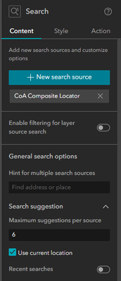

For this recipe, we will need a Map Widget, a Search Widget, a Near Me Widget and a List Widget. Let's drag them all into our Experience now and we'll set them up as we go. Start with your Map Widget and select the webmap you want to use. Then, go the Search Widget and pick a locator source. You'll also want to open the Search Suggestion options and check the Use Current Location option.

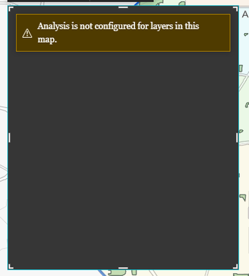

First, I select my Map Widget. At this point, Near Me will display this scary and confusing warning.
This is normal. Near Me is asking you to click on the name of your map again to open up the Analysis settings menu.

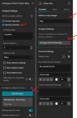

In the Analysis settings menu, pick Specify a location, set some sort of buffer distance (I went with 5 miles.) and the click the Add Analysis button.

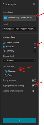

In the next window, I picked Analysis Type > Proximity and Sort features > Distance. (I also turned off Highlight results on map.)
I also opened the General Settings and set the Sketch Color to rgba(255,255,255,0). (Translation: transparent white.) In testing, I found that the default transparent option made a dark grey circle that was actually still very noticable, but by using transparent white there was just a faint dimming of the map and a barely visible edge of the circle.

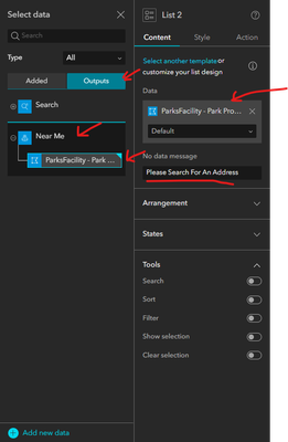

In the List Widget, click Select Data > Outputs > Near Me > Whatever I Named My Near Me Output. (I'm also going to add a No data message to tell the user to use the Search Widget.)
And there we go, when I search in the search bar the data will be transferred to this List. Style up your List Widget as you see fit. (Here's a post about all the various List Widget options.)

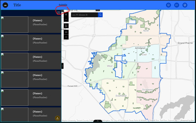

At this point, we have a Search Widget that automatically fills Near Me results into a List Widget. We don't need to look at the Near Me Widget anymore. So what can we do with it? Delete it? Send it to the Pending List? Stick it in a Section or Widget Controller? No, doing any of those things would break this build. We are going to do something far stupider. We are going to make it tiny. In the Style Tab of the Near Me settings, set the Width and Height to 0px. Experience Builder won't truly honor my 0 x 0px request. It seems that the true minimum widget size is 16 x 16px.
See that tiny box I circled in red. That's my Near Me Widget. It will happily do its job even if the user can't read anything in it. Should I need to alter any of my Near Me options later, I can click my little box and the settings panel will appear.

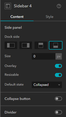

Well, we could be happy with our tiny box taking up some unimportant part of the screen, but if you really want it hidden. You can use a Sidebar Widget.
I've put my tiny Near Me Widget in the collapsable side of a Sidebar Widget. Set its size to 0px, Default state to Collapsed and turned off the Collapse Button.
Tiny Near Me will happily keep doing its job banished to an undefinably thin, unopenable Sidebar Widget and your users will never know exists (unless they inspect your page with their browser's Dev Tools).
