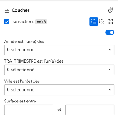

The idea was simple: what if I used the Selection tool to simulate a Selection action without the user realising?
So we're going to take a Selection Widget and choose ‘Select according to attributes’ as the source. Then click on ‘New data’. To follow my example, I'm going to choose my data source ‘Transactions’ (in my case it's a simple Table), thanks to the SQL expression generator, I'll be able to set up Filters that will be used to select the data according to attributes (I'm using several fields with the ‘AND’ condition).
Once that's done, all that's left is to set up actions when there's a Modification of record selections. This action is set up with ‘Structure’ as the target, then ‘Filter data records’ is selected and all that's left is to choose the Building source (or any other source) which has an identifier in common with the transactions (in my case we have an ID called ‘ID_LP’).
The final result is as follows:
As you can see, we ‘disguise’ this Selection widget as being a sort of Filter widget, and thanks to this, I can filter my transactions according to using fields that are not present in any other table or entity layer AND I manage to filter my other cascading data sources. Something that used to be impossible.
The other advantage is that, because we've set up our actions so that the data records are filtered, it doesn't show up, either on the map rendering or even in a Table or List Widget. There's no big highlight.
