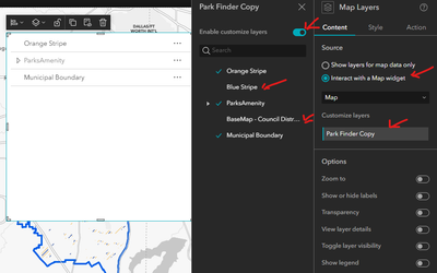

In the October 2023 ArcGIS Online update, the Map Layers Widget received an update that allows for multiple Map Layers Widgets on the same map to be customizable. This update was made to better organize groups of related layers.
How To
  1. Add a Map Layers Widget.
  2. Select Interact with Map Widget and pick your map in the dropdown.
  3. Click your map under customize layers.
  4. Enable Customize Layers and deselect all the layers not in the group you are building.
  5. Repeat for each group you want to make.
  6. Organize your Map Layers Widgets into a Widget Controller with a unique icon and title for each group or collect them all into a Card or some other layout widget.

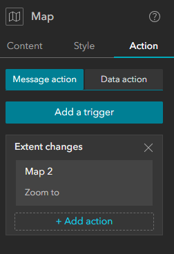

  5. Use the Message Action > Extent Changes > Map > Zoom To option on each map for each other map to keep your extents in sync (or your end-users will be very confused).
It is possible to do similar workflows with multiple pages or a Widget Controller, but the Section widget is going to be the best choice in most cases.

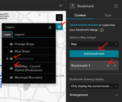

This last method could be the best option in many cases and it never occured to me until it was pointed out by a new user, @JasonBOCQUET, a few weeks ago. The Bookmarks widget contains an option to set what layers are active at a given view, so let's make use of that.
How To
  1. Add a Bookmark widget and pick one of the Advanced Templates. Selecting the Advanced Template will allow you to fully customize how you want your Bookmarks to appear (just text, text and an icon, just an icon, a picture of the map with the layers on, or anything else you may want) and it also turns off the option for a user to create their own bookmark, which we want turned off for this hack.
  2. Add a bookmark.
  3. Hit the little map icon to Change the Bookmark View.
  4. Select the Layers icon and turn on/off the layers to match the thematic group you are building.
  5. Hit save.
  6. Repeat steps 2 to 5 for each group.
  7. Style your bookmarks as necessary.
  8. If you are using this widget in a Widget Controller, you will need to give it a more appropriate name.
