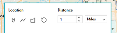

  2. Each of the map selection options should be individually removable in the builder mode. I could see putting in the pin and the distance chooser in my application, but I don't want the line or polygon options.JeffreyThompson2_0-1690291443324.png

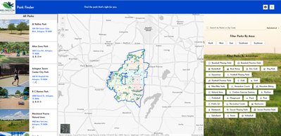

@AzizaParveen1 Thank you for your response. I am aware that Near Me can be used in these ways. They are not a replacement for my requests. As for request #3, adding a single button press Near Me search is just better UX than requiring the user to know to go to the search bar and use current location. As for request #1, please take a look at a screenshot of my app.
  1. There really isn't physical space in my layout for another separate widget and space is even more of a premium on mobile view.
  2. This is designed to be used by members of the general public who have never seen this site before. Asking them to figure out the Near Me interface is too much work and many users will get frustrated.
  3. I have spent a lot of time making these nice cards in my list. I want the users to see them as previews of what can be found in the park. Yes, I know I can configure the popupTemplate and Near Me will show that. It's still not the same thing and popups are being used for a slightly different purpose than the cards.
  4. Filtering the list also filters the map. Near Me doesn't do that.
  5. After running Near Me, if the user changes their filters, Near Me will not respect the changes.

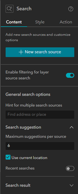

100% agree. I'm starting to configure NearMe and I'm baffled as to why after I click the "My location" widget NearMe doesn't just show me the results. I have to now click and add a point on "My location" on the map. Am I missing something? Seems like an improvement needs to be made to this widget for sure.
*Edit - yes, I was missing something! Turns out a very important step from that blog is "Expand Search result and check Auto select the first result.". Then the Current location from the Search Widget will work. The My location (beta) widget doesn't work.
