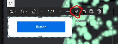

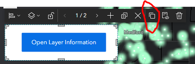

  3. Use the Duplicate View Button to copy this View with the Button. Rename View to Open Layers and View 2 to Close Layers.JeffreyThompson2_0-1730131208602.png

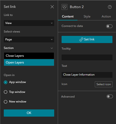

  5. In the Content Tab of the red Button, Set Link to a View then select the Open Layers View and change its Text to Close Layer Information. JeffreyThompson2_1-1730133100160.png

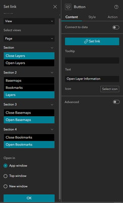

  3. In the Section Widget with the Buttons for controlling the Map Layers and Legend Widget, click on the blue Open Layers Button.

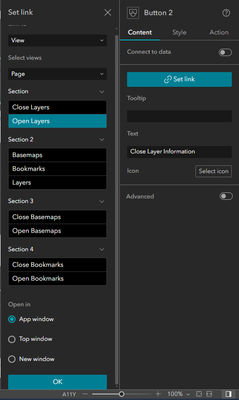

  4. Click Set Link and set it with Close Layers, Open Basemaps, Open Bookmarks, and Layers. This set of links should switch the Layer Button to the close Action, get the Bookmarks and Basemaps ready to be opened, and open the Sidebar to the Section containing the Map Layers and Legend Widgets.JeffreyThompson2_1-1730142347672.png
  5. In the same Section Widget, go to the other View and click on the red Close Layers Button. Ensure that the Set Link is set to Open Layers and all the other Sections are blank. Note: If you have followed along, you shouldn't actually have to do anything on this step. This link should already be made for this View.JeffreyThompson2_2-1730143089422.png

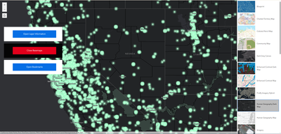

  10. Save. Go to Preview Mode and test. You should be able to click any of these Buttons in any arbitrary order and get a logical response. At any given time, you should see the Sidebar closed with three blue, open Buttons or the Sidebar open with the selected Button in the red close Button state, the correct Widget open, and the other two Buttons in the blue open state.JeffreyThompson2_3-1730144504928.png

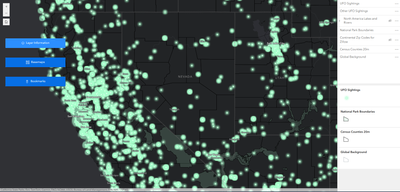

  11. Fix up your presentation. I'm leaving out the details here, but here's how it looks after a little re-design.JeffreyThompson2_4-1730145569444.png
