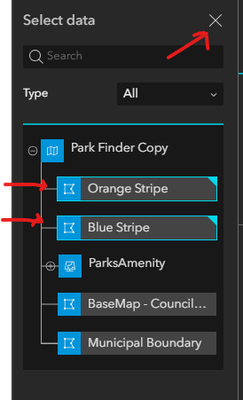

Press the Select Data button, then highlight all the data sources you want to filter, Orange Stripe and Blue Stripe for me. You'll need to press the X up top when you're done.

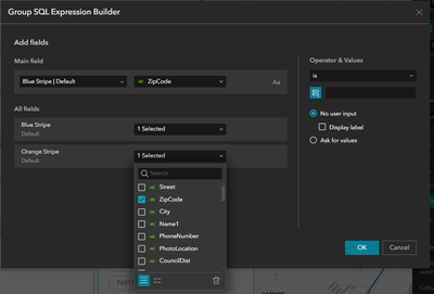

Now click the Group SQL Expression Button and select Zip Code in the Main field. Next, I will need to select Zip Code in my other layer.

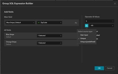

Under Operator & Values, I will use the Select Source Type Button to switch to Unique values. And hit the Ask for Values option.

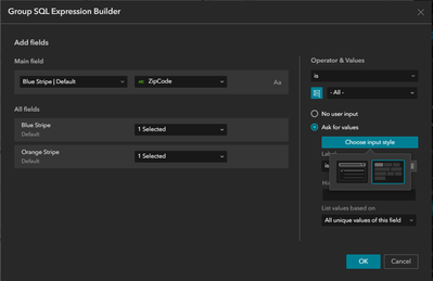

This Choose Input Style Button lets you choose between a dropdown menu or a set of buttons. I generally favor buttons as they are better for user experience and accessibility.

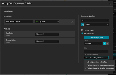

I'll set the label to Zip Code to clarify to the user what these buttons are. Then, I'll go to the List Values Based On dropdown. This is how I'll filter my filter.
There are three options here All Unique Values of this Field will always show all of the zip codes in the layer. I have not found a functional difference between the other two options, but they will reduce the number of possible zip codes when other filters are used.
Here is the trick to making the filtered filters work: the other filters must be on a seperate Filter Widget.

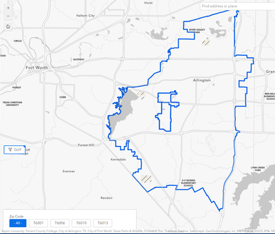

As my application opens, I see 87 parks in two data layers and twelve zip codes.
I turn on my golf filter and both data layers filter down to four parks and my zip code filters also reduce to the four zip codes with golf courses.
