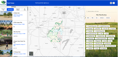

My first real, released to the world Experience Builder project was called Park Finder. It was designed for the citizens of Arlington to go in click some filters and find out what parks meet their criteria. Let me give you a quick tour and explain a little about how I made it.
In the lower right of the map, is a custom widget for switching between two basemaps made by importing the Basemap Toggle Widget from the Javascript API. At the time I was working on this project, the Experience Builder Basemap Gallery Widget did not exist and the Basemap Tool had too many choices. Plus, there is a simple elegance to how the Basemap Toggle works. Could I have used multiple maps within my Map Widget to achieve the same effect? Yeah, I guess so, but it was easier to just make my own Widget than to configure multiple maps and all the Actions to make it all work. All in all, I'd rate this custom widget as technically reproducible in Online, but it would be nice if it was a standard widget.
Now, let's look at the right side of the screen. Up at the top, there's a search bar, but it's not actually a Search Widget. It's a List Widget, but I've used CSS to hide everything but the search bar. I don't entirely remember why I did it this way, but I think it was mostly about that annoying Results Panel that wouldn't go away after a search. As of a few days ago, that Results Panel is now optional. So, I'll mark that design as functionally replicated in ArcGIS Online.
Moving down the right-hand column, we get to the filters. The first set of filters are tied together with an OR statement and are using geographic labels in the data to filter by area. Down below, we have filters tied together with an AND statement that allow the users to filter by the amenities the parks have. So of course, I needed to use a custom widget to make such complicated filters, right? No, those are just OOTB Filter Widgets. Ok, not quite. I did use some CSS to make the buttons closer together and change the highlighting color when they are selected. But, functionally they are just two Filter Widgets.
Shortly before we went live with this application, someone in the Parks Department asked if the filters could filter themselves as the user made their choices. At the time, the answer was no. And it was deemed too much work for me to make my own filter widget and re-build the entire application around it, so that idea didn't happen. But now, yes, filters can filter themselves. So all-in-all, I wish the Filter Widget had some more design options, but it's at least advanced functionally.
Now, let's look over at the left side of the screen. That List Widget is not a List Widget. It is a built from scratch custom job. Mostly so I could make those little icons that show what amenities each park has. Until we get an option to put a List Widget inside another List Widget, an idea that is never going to happen because it would be an absolute nightmare to code with a billion possible unintended consequences, that isn't going to be possible in ArcGIS Online.
Across the top of the custom list are a set of buttons that sort the list in several different ways. And finally, after all that introduction, we are finally getting to what this post is really about. While I was working on this application, the first version of Near Me was released. The release of this application was actually delayed so I could incorporate Near Me into the design. And then, I didn't. It just didn't work in this design. Instead, I built my own geographic sort, an incredibly complicated process that I never fully got all the bugs out of.

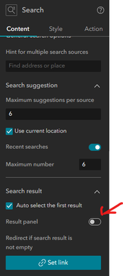

We'll start making our changes in the Search Widget. In the Action Tab, I have added a Open Sidebar Action to my existing Record Selection Changes Action to open the Output Sidebar. I also deleted the Zoom To Action I previously configured. Apparently, in the last update, a default zoom action was added to Near Me. Having a zoom action on the Search Widget and Near Me was causing a nauseating bouncing effect as the Search Widget first zoomed in then Near Me zoomed back out a bit. In the Content Panel, I scrolled down and opened up the Search Result options to use the new option to turn off the Result Panel. I will be putting the Search Widget under the Output Sidebar later and turning off the Result Panel prevents a visual glitch where the Result Panel clips through the Sidebar.

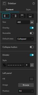

Almost done, I promise. Go to the Output Sidebar and set the Size to 400px, Overlay on, Resizable off, Default State Collapsed and Collapse Button off. I also gave the Left Panel a Fill color to match our Theme. This prevents the Output Sidebar from being see-through and showing the filters below. With these options set, there will be no way for the user to interact with the filters while looking at the Output List, preventing the inaccurate data issue discussed above.
