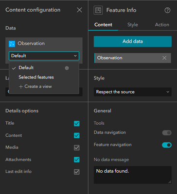

  1. Go to the Feature Info Widget Settings Panel Content Tab.
  2. Click Observation. (That is the name of the layer used in this Widget.)
  3. Open the dropdown menu under Observation and select Create A View.JeffreyThompson2_1-1729707075044.pngJeffreyThompson2_1-1729707075044.png

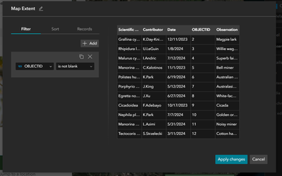

  4. In the window that pops up, Add A Clause and set it to something that will not filter anything. OBJECTID is not blank should do the job of not doing anything.
  5. Change the name of this Data View to Map Extent to clarify why it exists.JeffreyThompson2_2-1729707458581.pngJeffreyThompson2_2-1729707458581.png
  6. Apply Changes. Then, open up that dropdown menu under Observation again and select Map Extent.

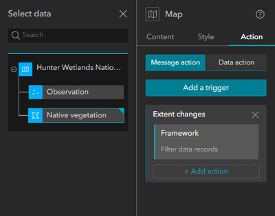

  7. Go back to the Map Settings Panel Action Tab.
  8. Click on the Filter Data Records Action I made earlier. Then, click Select Data.
  9. Select Observation to add an additional layer to filter. Then, hit the X button at the top of the Select Data Panel.

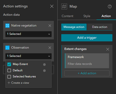

  10. This should bring you to the Action Settings Panel. Under Observation, open the dropdown menu and select Map Extent and de-select Default.
Now, the Feature Info Widget should filter as we zoom around the Map.
