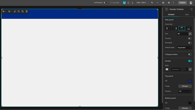

Oh, the tyranny of the blank page... How shall we start? Well, if you know my stuff, you know I'm probably going to use a Sidebar, actually this layout uses five Sidebars, each one in a slightly different way. The first one is to support our Hidden Widget Trick. I drag in a Sidebar and set it to Full Size. In the Collapsible side of the Sidebar, I drag in my Custom Font Widget. Back in the Settings Panel of the Sidebar Widget, I'm going to click on the Widget's title to change the name to something more descriptive. We're adding a lot of Sidebars and this will get confusing without some labels. Next, I'll set the Size to 0, turn off Resizable and the Collapse Button, and set the Default State to Collapsed. The Custom Font Widget is now hidden forever, but it's font changing powers will live on.
Next, we are going to add a "Header" and, since we are not planning to add another Page to this layout, we aren't going to use a Header. Instead of a real Header, we will use a previously unreleased trick by @MichaelGaigg: Sidebars make good Headers. I drag in a Sidebar and set it to Full Size. In the Settings Panel, I'll rename the Sidebar, set the Dock Side to the Top, Size to 80px, turn off Resizable and the Collapse Button, and set the Top Panel Fill to a dark blue. Our Sidebar is now a Header.
