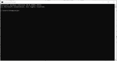

If you don't know what scary black box I'm talking about, it's this one...
This is the Windows Command Prompt. (Some users report better performance with Windows PowerShell. I do not notice a difference. I will use Command Prompt below, but these commands should all work in PowerShell as well.) This is what you will use to start and stop Experience Builder Developer Edition.

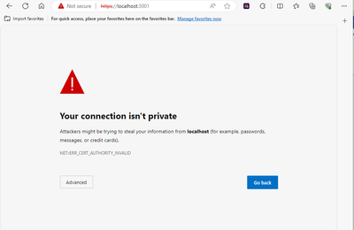

Open up a browser and type https:\\localhost:3001 in the navigation bar. The first time you visit (and periodically on other sessions) you will see a warning that this site is unsafe. localhost is your own computer and it is actually perfectly safe. In Microsoft Edge, the warning screen looks like this. (The warnings from Chrome are virtually identical.)

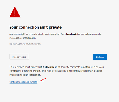

Hit the Advanced button and then say that you want to continue unsafely to localhost.

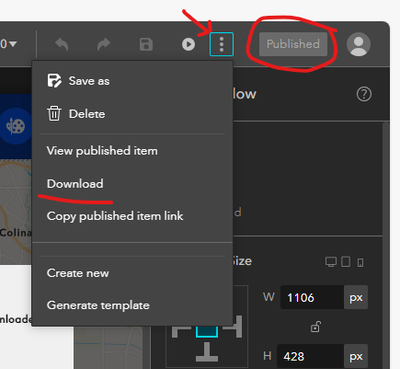

After getting through the sign-in screen, working in Experience Builder Developer Edition should be the same as in the Online/Enterprise versions. When you have completed building your project, you will need to press the Publish button, then open the three dot menu and select Download. This will create a zip file of your project that can be deployed on a web server. (It helps to run your Command Prompt in Administrator mode for this step.)
