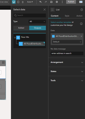

Step Three: Send Near Me Results To A List Widget
In the List Widget, click Select Data > Outputs > Near Me > Whatever I Named My Near Me Output. (I'm also going to add a No data message to tell the user to use the Search Widget.)
And there we go, when I search in the search bar the data will be transferred to this List. Style up your List Widget as you see fit. (Here's a post about all the various List Widget options.)

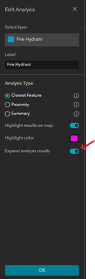

I second all the issues described. I will add
1) When an address is entered in the search bar and the Near Me widget runs its magic, you would expect the analysis results to simply display a list of nearby locations. However it strangely displays a collapsed summary. You have to click it to display locations. Just show the locations expanded please.

@Alan_Halter The Expand Analysis Results option should take care of your first complaint.
