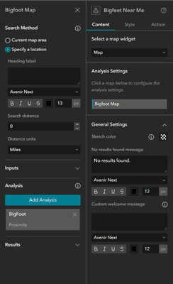

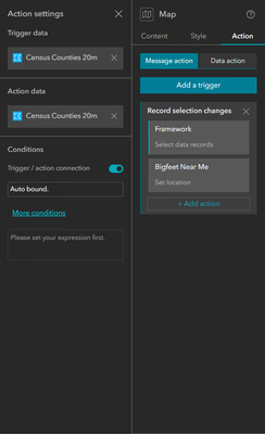

Let's add a Map Widget and connect it to our Bigfoot map. I'm going to turn off popups. I think it will be better that way. Then, I throw in a Near Me Widget and rename it Bigfeet Near Me. In my Near Me settings, I will set the Search Distance to 0. I go to Add Analysis and select my Bigfoot layer and set the Analysis Type to Proximity.  (To all the confused people who just typed the first four letters of analysis and big feet into their search engines, this isn't the site you are looking for.) Now, go back to the Map Widget Settings Action Tab. Add a Record Selection Changes>Framework>Select Data Records Action and set both the Trigger and Action Data to the Counties layer. Then, Add Action and Bigfeet Near Me>Set Location. This should find all of the Bigfeet in a county by mouse click.

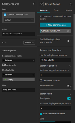

Step Two (Optional): Search By Layer Source
Add a Search Widget. Add New Search Source and select the Counties layer. It would be good design to change the Hint to something that clarifies that the user should enter a county name. Turn off Enable Filtering For Layer Source Search. I've also renamed my Search Widget to County Search. In the Action Tab, add a Record Selection Changes>Map>Zoom To Action and then a Bigfeet Near Me>Set Location Action. Zoom To should be before Near Me, apparently this order matters. Now, searching for counties should find Bigfeet.

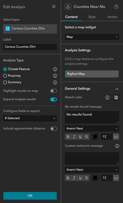

This is where it gets a little weird. We are going to double up Near Me. (Google people, go away, this still isn't what you want. (Seinfeld voice: Not that there's anything wrong with that.))  Add a second Near Me Widget. We'll call this one Counties Near Me. As before, set the Search Distance to 0. This time set the Analysis Type to Closest Feature. You will also want to turn off Highlight Results On Map. In the Action Tab, add a Record Selection Changes>Bigfeet Near Me>Set Location Action.

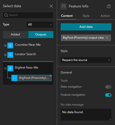

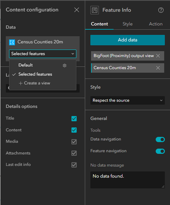

Depending on how your user searches and in what order, the Counties Near Me Widget may fall out of sync with the currently searched for Bigfeet. So you will definitely want to hide it. And I still ain't a fan of how Near Me looks so I'll hide both of them. To make my output, I will use the newly updated capabilities of the Feature Info Widget. To get my Bigfeet, I will go to the Outputs Tab>Bigfeet Near Me>BigFoot (Proximity) Output View.

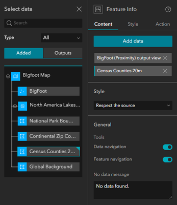

For the Counties, I will add the Counties layer from my map in the Added Data Tab. Then, I will click back on the Counties layer in the Settings Panel to get more options and use the dropdown menu to pick Selected Features.

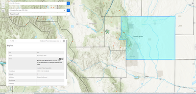

Go find big feet near you from the safety of Experience Builder.
