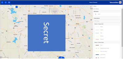

Telecom Editor
Why: To Make A Focused Application
We have a group of people in the city who are tasked with building out the telecom infrastructure used in city operations. They also must track the telecom infrastructure built by private companies within the city. These people are not GIS people. They don't need access to all the data in the city. They need access to telecom data and they need to be able to edit it. That's it. Anything more than that would be more confusing than helpful. Could they use the Webmap Viewer? Sure, but it just wouldn't be as dedicated to doing one thing. ArcGIS Pro? Way more confusing.
How: ESRI Widgets
This application is pretty basic. Fundamentally, it is just a Map Widget, an Edit Widget and an edit enabled Table Widget. It does have a few custom widgets, but none of them are essential to the application.
At this point, I would like to explain that my job is specifically to build stuff that is more complicated than can be done with OOTB tools. The next two projects are significantly more complex. The best way to keep a project within the OOTB capabilities of Experience Builder is to keep it focused on a small number of closely related tasks. Trying to build an everything app in Experience Builder is a really bad idea...

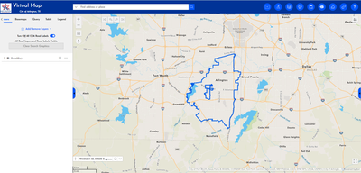

Virtual Map
Why: It's An Everything App
We want every city employee to have access to all the city's authoritative data. People in different departments need access to different things and to do different things, but sometimes they also need access to other sources of data. In many ways, this is a simplified version of ArcGIS Pro dedicated explicitly to city data. As above, most of the users are not GIS people, many of them are not even computer people, so the Webmap Viewer and ArcGIS Pro are not realistic options. With the retirement of WebAppBuilder, the only viable options for building such an application is Experience Builder or the JavaScript API. And as I see it, Experience Builder is the JavaScript API with some helpful UI components built-in. In retrospect, a series of department focused applications may have been faster, easier and better, but an all-in-one application is still possible.
Why: It Saves Us Money
Shhhhhhh! Let's keep this one quiet. Don't put this anywhere ESRI can hear about it.
An ArcGIS Enterprise subscription comes with unlimited Viewer licenses which is all that is necessary for our users to log into Virtual Map. At standard list prices, an ArcGIS Pro subscription for all of our Virtual Map users would cost the city approximately two million dollars a year. And that's not counting training or hiring additional tech support personnel.
For all the GIS Administrators and Managers out there, how many people in your organization really need a Pro license? How many of them could instead be using the Webmap Viewer or one of the various web apps to do their jobs? It might be more than you think.
How: Time and Communication
Virtual Map was in development for over a year before it was officially released and it's still not entirely finished. It may never be truly finished. Why did it take so long? There were some external delays and I was also working on other projects, so several months of unproductive time were being counted in there. But one of the biggest reasons it took so long is we were trying to get it right. Throughout the entire process, we were communicating with the users to try and make what they needed. Versions of the application were available for testing six months before the official launch. You'll see the other big reason it took so long a little later.
