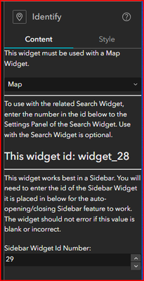

I know updates can break things.  I'm working with 11.3 and ExBdev 1.15.  I've incorporated the  Identify widget only (not the search) and all it does is close the sidebar.
I'm also confused about the widget ID.  If I poke around through the developer window in Chrome, it looks like the widget ID is 29 (and setting this makes the sidebar close).  But the image below says "This widget ID: 28" but if I use that, nothing happens when map-clicking.  Is this setup correctly or is it broken at 1.15?
JeffreyThompson2
MVP Frequent Contributor
@PLadd I am currently out on paternity leave and have not yet tested this widget in 1.15. I don't believe it should have broken. Make sure you are testing on Feature Layer. The id number in that box should be the id of the Sidebar Widget.
