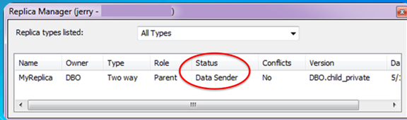

Before running any tools, use the replica manager to confirm which geodatabase in your replica is the data sender.  *Always check this status from both the parent and the child.

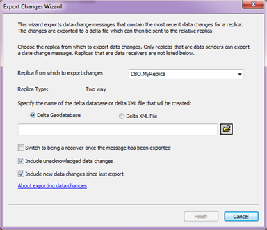

Step 1: Export Data Changes from the Data Sender.
If you are using a two way replica, and need to synchronize data in both direction, check the 'Switch to being a receiver once the message has been exported' so this workflow can be done in the opposite direction later.
Exporting the changes to Delta Geodatabase allows you to see the records with updates, inserts, and deletes that are being synchronized.  If features have not been updated, inserted or deleted since the last synchronization then you will not see those records in your Delta Geodatabase.
Esri Support insight:  If other synchronization methods fail, this is my go-to option for troubleshooting that failure.
This step can be compared to saying “Hello” to start a conversation.

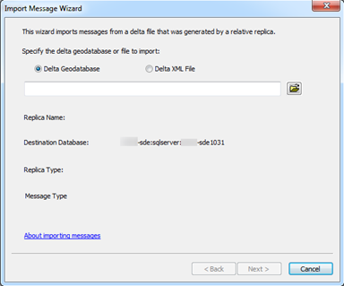

Step 2:  Import those data changes into the Data Receiver using the Import Messages Wizard.  Since our output in step 1 was a file geodatabase, we will choose to import a delta file geodatabase here.
This step can be compared to hearing someone say “hello” to you to start a converstaion.

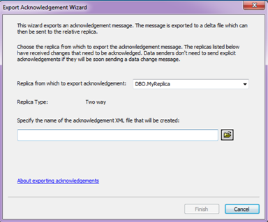

Step 3:  Export an Acknowledgement Message from the Data Receiver.  This output will be an XML document.
This step can be compared to saying “hello” back to someone who just greeted you.
Step 4:  Import that Acknowledgement Message into the Data Sender.
This step can be compared to someone hearing your “hello” reply.
Now that you have completed the disconnected synchronization workflow, let’s look at the statement above.
  • Can you now think of WHY it is important to check the status from both the parent and the child?
  • If you see both the parent and the child have the same status, what would you do to reconcile that so that only one geodatabase is the sender, and the other is the receiver?
