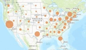

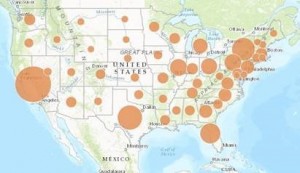

Starting with the June update of ArcGIS Online, sizing values will be correctly represented using points which will enable marker sizing in web maps to be displayed consistently in all ArcGIS clients. The ArcGIS API 3.17 for JavaScript was also updated to use point values rather than pixels. While this update resolves the inconsistencies with auto sizing values going forward, it also means that web maps that were created before the June 2016 update of Online will have marker symbols and polygon outline widths that appear 1.3 times larger than the initial sizes you saw when originally authoring your map.Example map with automatic sizing before the update            Before-resaved-300x173.jpgExample map with automatic sizing after the updateAfter-resaved-300x174.jpgWhat can you do if your web map was affected by this update?
