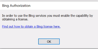

This worked, along with the bing key, when the user obtained this error message:
