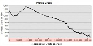

A Profile Graph represents height on the Y axis and horizontal distance on the X axis. The unit of distance along the X axis depends upon the units of the projected coordinate system (PCS) of the elevation raster data. For example, if data is in a Universal Transverse Mercator (UTM) PCS, the unit of distance will be in meters; if data is in State Plane PCS, the unit of distance will be in feet (US) as shown in the following figure.
However, sometimes it might be inconvenient and hard to understand the following: The elevation changes from 1,200 feet to 1,400 feet over a distance of 400,000  feet.

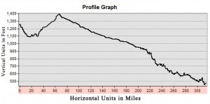

In fact, it is more meaningful when data is displayed in the following manner: The elevation changes from 1,200 feet to 1,400 feet over a distance of 80 miles as illustrated in the following figure.feet-vs-_mile-copy-300x149.jpg

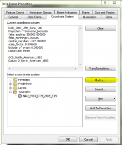

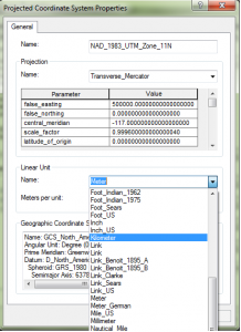

1)      Open Data Frame Properties  (View > Data Frame Properties)
2)     Click on Coordinate System Tab
