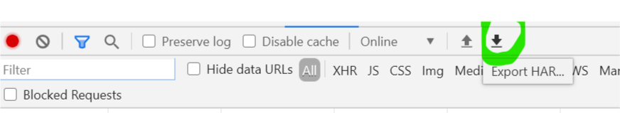

Also, Chrome Dev Tools>Network>export Har
