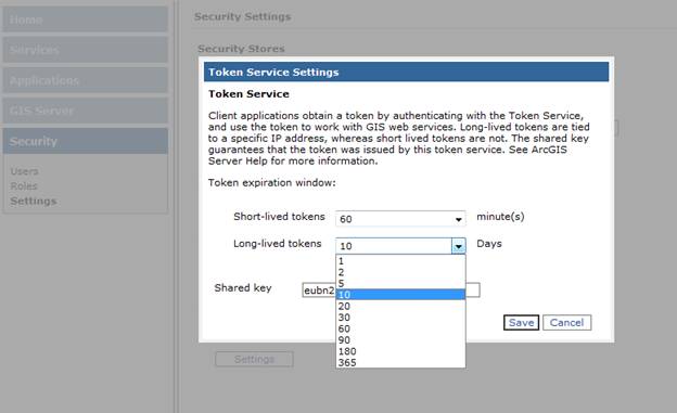

There are a couple of ways to edit the time limit for a token.Method AChange the token expiration period for both 'Short-lived' and 'Long-lived' tokens using the ArcGIS Server Manager.
  1. Log into the ArcGIS Server Manager.
  2. Go to Security and then go to Settings.
  3. Under the Token Service heading, click the Settings button.
  4. In here, you can change 'Long-lived tokens' to 365 days (or any other length of time) then click Save.
  5. The next time you open the ArcGIS Token Service web page you should be able to set the expiration date to 365 days.2.jpg

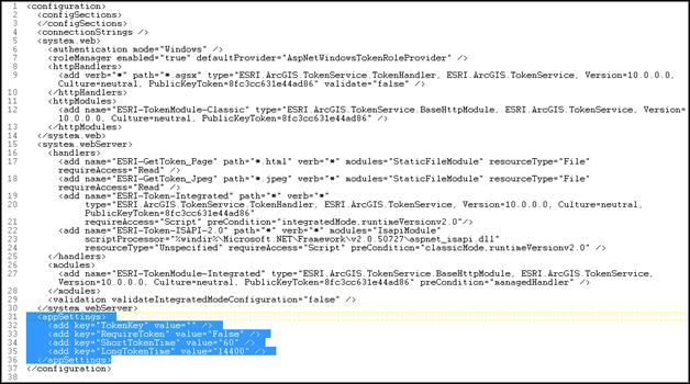

Method B
Edit the web.config file to change the value of the 'Long-lived’ tokens to 365 days.
  1. Browse to the web.config file (C:inetpubwwwrootArcGISTokens).
  2. Open the web.config file in a text editor.
  3. In the appSettings tag, look for . The default value here (highlighted in blue) is 14400 minutes, or 10 days.3.jpg
  4. Increase this value anywhere up to 525600 minutes (365 days).
  5. Save the file and use it to replace the web.config file that already exists on your web server.
