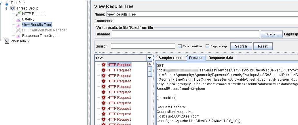

Below is a sample request with the Authorization Manager disabled:

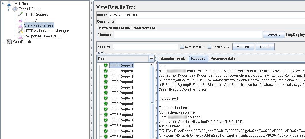

Below is a properly configured HTTP Authorization Manager:
Here you can see JMeter sending authentication information in an Authorization header: NTLM.
