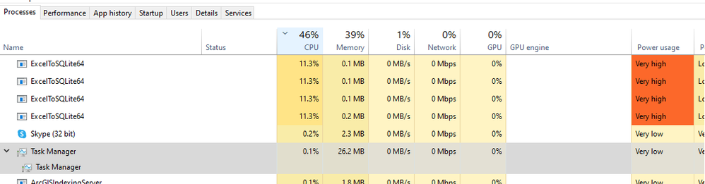

I had this problem today and the worse thing is that I did NOT use ArcGIS Pro 3.0.1 at all today!
I was wondering why my fan was running at max speed for a while when I wasn't doing anything and Task Explorer showed me the culprit: ExcelToSQLite64.exe!
See image.
NOTE: I'm on a laptop and this seem to have started when I plugged in my laptop but can't confirm it was exactly at that moment that it started.
ExcelToSQLite64.exe using 46% of my CPU without using ArcGIS Pro 3.0.1ExcelToSQLite64.exe using 46% of my CPU without using ArcGIS Pro 3.0.1
CECNorthAmericanAtlas
I confirm: After working on battery power, when I plug in my laptop, for no reason whatsoever ExcelToSQLite64.exe starts running like crazy.
NOTE: I am not even running nor started ArcGIS Pro 3.0.1 during the day and my computer was completely off when I turned it on this morning. This process should not start at all.
