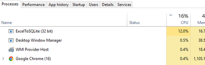

I started ArcGIS Pro this morning and ExcelSQLite is sucking up 12% of my CPU, when I haven't done anything but load the program. At least I'm not on battery!
