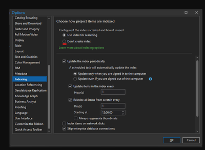

MHeynen1
Turning off the indexing option has been a solution for some users. It seems as thought the solutions, and in some instances the behavior, are similar to ArcGIS Pro 2.7

LyleMariam
Interesting, I turned off Indexing and closed ArcGIS Pro. Checking TaskManager I found that ArcGISIndexingserver and ExcelToSQLite were killed. It's been running for a few minutes and I haven't seen them restart. This could be the solution to high CPU usage!
Of course, if you look at the CPU usage for the indexing service, it is almost zero. The hog is the ExcelToSQLite process which on my computer is about 12% of CPU usage. I don't see how indexing should spawn the other process. Just from reading the file name, I would assume it handles taking Excel input data and stuffs it into a SQL database. It's difficult to understand if you're indexing files why would you need to import Excel data?
Update: Turning off indexing seems to have solved the high CPU usage problem I was experiencing. I haven't noticed ExcelToSQLite or the indexing server starting. My PC has been running almost 9 hours after turning off Indexing and I haven't see any evidence of high CPU usage. My Xeon system is only showing about 5-8% CPU usage when previously it would have been around 20%. I'm running ArcGIS Pro + a number of applications with AC/DC Let There Be Rock to boot.

LyleMariam
As of this afternoon, it is working fine and I'm not having any issues with ArcGIS Pro after turning off the Indexing feature. Fingers crossed that solved the issue.
