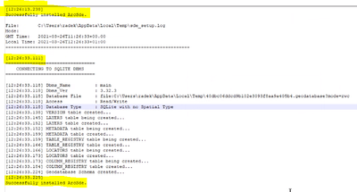

On our side, when the PRO is running, the process is writing each 30 seconds approximately some runtime geodatabases to TEMP folder and logging it (see the screen below).
So it´s depleating the space on HDD. It´s quite weird.

Hi Vladimir.  There is a more recent discussion about this that matches the behavior you're describing.  https://community.esri.com/t5/arcgis-pro-questions/huge-amount-of-geodatabase-files-since-arcgis-pro...
There is no resolution to this yet and as far as I know it is still being investigated by technical support and development teams.  So any additional information that you'd be able to provide regarding the project that is causing this (if you know) would be very much appreciated.  For example, what are the indexing settings, does the project contain Excel tables, etc.?
