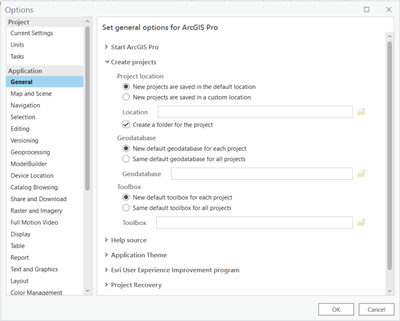

There are som settings affecting this that you could try to alter. E.g., you could choose that Pro should not create a folder for a new project. Similarly, you can choose to not create new project database and toolbox but use existing ones instead.
This could be used to have all .arpx files created in the same folder. That said, keeping the .arpx files in different folders is the standard setting.
