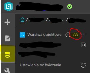

sunshineags
You need to select 'Data' from the left panel, then choose the appropriate layer and click on the gear.PNGicon.
Menu.PNGLet me know if you were able to find it 🙂
