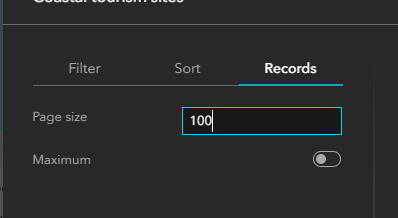

Cyprus_Forest_Department
Can you please guide me how to find that menu on experience builder? Thanks in advance.
sunshineags
You need to select 'Data' from the left panel, then choose the appropriate layer and click on the gear.PNGgear.PNGicon.
Menu.PNGMenu.PNGLet me know if you were able to find it 🙂
