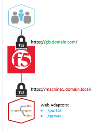

Step One: Design Decisions and Communication with F5 Administrators
In this configuration, clients will address ArcGIS Enterprise through the reverse proxy.  The reverse proxy presents a CNAME (“DNS alias”, shown in green in the diagram below) which terminates the HTTPS sessions from the clients.  It then re-initiates new HTTPS sessions from itself to the web server that hosts the web adaptors.  The web server usually presents a certificate with the subject name of the A record (the host name, shown in red in the diagram) which terminates the incoming HTTPS sessions from the BIG-IP reverse proxy.
Before deploying your system, you need to make the following decisions:
  1. What is the CNAME (“DNS Alias”) under which the reverse proxy will represent the ArcGIS Enterprise system?
  2. What are the “contexts” (“Web Adaptor names”, shown in blue in the diagram) for the Portal for ArcGIS and ArcGIS Server Sites?
You likely need to cooperate with your F5 administrators to agree upon the CNAME and ensure that they have a TLS certificate appropriate to terminate HTTPS communications on that CNAME.  At the same time, you can share with the F5 administrators the name (the A RECORD) of the machine on which your web server will operate and to which requests should be forwarded.

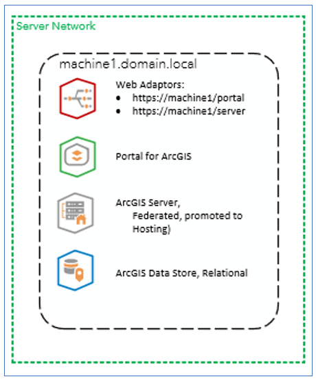

Step Three: Deploy and Configure ArcGIS Enterprise
The ArcGIS Enterprise deployment here is a “single-machine base deployment” (https://enterprise.arcgis.com/en/get-started/latest/windows/base-arcgis-enterprise-deployment.htm#ES...).
Install and Configure the Basics
Documentation to take you through the installation steps is available on Esri’s web site: https://enterprise.arcgis.com/en/documentation/install/.
In this article, the Portal for ArcGIS’s Web Adaptor name (“context”) is “/portal” and the Hosting Server’s Web Adaptor name is “/server”.  When you federate your Hosting Server Site with your Portal for ArcGIS, you may use the Web Adaptor for both the Services URL and the Administration URL (https://enterprise.arcgis.com/en/portal/latest/administer/windows/configure-servers.htm), so long as you are not using Web Tier authentication.  If you are using Web Tier authentication, your Administration URL should follow this pattern:  https://machine1.domain.local:6443/arcgis.

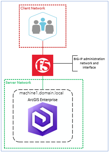

From a BIG-IP perspective, this is a simple configuration.  The ArcGIS Enterprise system has several components.  But, from the standpoint of the reverse proxy, there is a single back-end web server node listening on HTTPS/443.  The one configuration element that may be different to other systems is that ArcGIS Enterprise requires the reverse proxy to include an X-Forwarded-Host header.
At a high level, your proxy configuration will be terminating all HTTPS traffic to the gis.domain.com CNAME and re-initiating HTTPS to the single back-end node, machine1.domain.local.  The web server at this address supports two “contexts”, one for each major component of the ArcGIS Enterprise system (Portal for ArcGIS and ArcGIS Server): /portal and /server.
As described in the introduction of this article, we assume that you have three networks associated with your BIG-IP proxy, a client network, a server network, and your administration network.
This article assumes you are an expert in BIG-IP administration and only need cues to the steps to configure this virtual server and backend pool in the optimal order.
Step One: Proxy the Web Server
The CNAME for this system should have been established with you or communicated to you.  A matching TLS certificate for that CNAME should also be provided.  The certificate authority must be one that is trusted by the clients of this system.

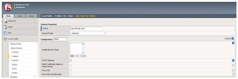

Create Client SSL Profile
Create a client profile to terminate client TLS connections on the certificate for the gis.domain.com name.
Local Traffic > Profiles > SSL > Client > Create

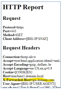

Create an HTTP Services Profile (Add the X-Forwarded-Host Header)
The X-Forwarded-Host header allows ArcGIS Enterprise to know the value of the Host header that arrived at BIG-IP.  The ArcGIS Enterprise system will check this value against its configuration to ensure that clients have addressed it in an appropriate way.  If the X-Forwarded-Host header is not present, or contains a wrong value, ArcGIS Enterprise will issue an HTTP redirect to signal how it believes it should be addressed.  This can result in redirect loops.  In the case that ArcGIS Enterprise detects a redirect loop, it will break it and return an error.
An X-Forwarded-Host header can be included with an iRule:
when HTTP_REQUEST {
        HTTP::header insert X-Forwarded-Host [HTTP::host]
This directive takes the value of the arriving request’s Host header and sets it as the X-Forwarded-Host header value to the default pool.

Validate Trust and Headers
Assuming the showHeaders.aspx page was deployed on the backend web server, use a web browser to navigate to https://gis.domain.com/showHeaders.aspx.  The browser should be free of certificate trust warnings.  The page response body should prove-out the effectiveness of the X-Forwarded-Host header aspect of your configuration.
At this point, with the header flow through to the backend confirmed, there is no longer a need for the showHeaders.aspx tool.  If your system is intended for PRODUCTION, or any environment where the information exposes should not be exposed, the tool should be removed.
