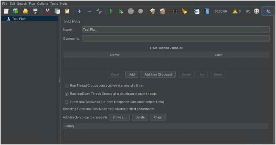

  • Start Apache JMeter
    • This automatically creates a new, empty Test Plan (e.g. a test project)

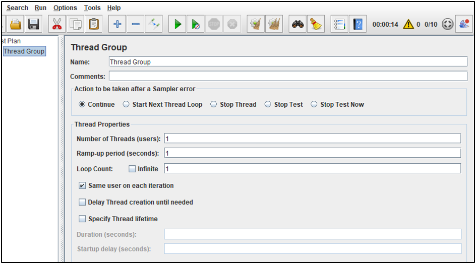

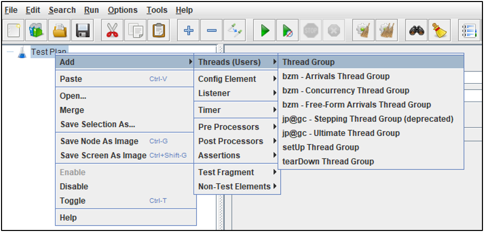

  • Right-click on Test Plan and under Add-->Threads (Users), select Thread Group
    • This is necessary for defining the test‘s pressure…if it will exert a step load or constant load
    • “Thread Group” just includes basic logic for defining a test’s step load (e.g. the test pressure)
      • Not every thread group will define a step...some are configured to just apply a constant pressure
  • The default values of the Thread Group (Loop Count = 1) will have the test run and execute the added web URL resource only once

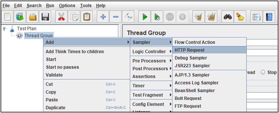

  • Right-click on the Thread Group and under Add-->Sampler, select HTTP Request

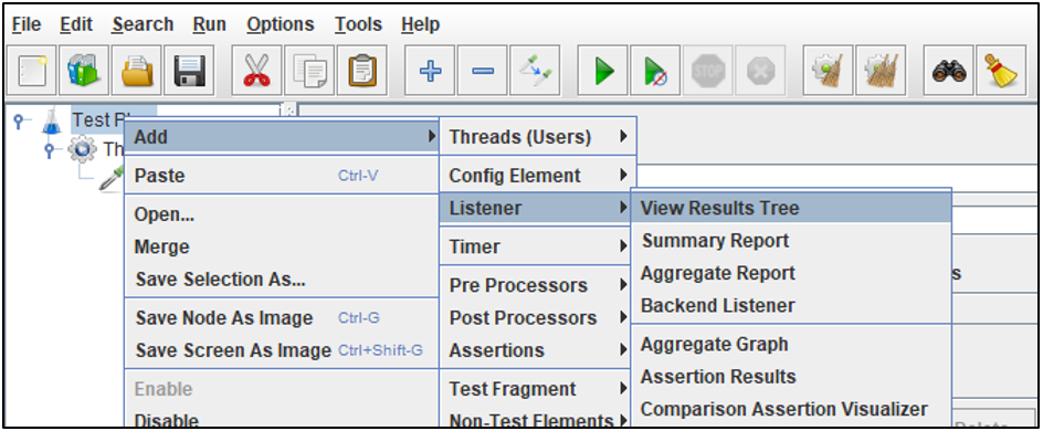

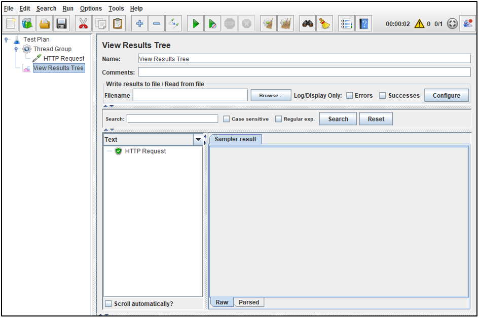

  • Use the View Results Tree listener to assist with validating the response in the GUI from the remote server
    • Right click on the Test Plan and under Add-->Listener, select View Results Tree
      • Apache JMeter provides many other listeners for validating the payload responses within the GUI, but for good spot-check analysis the View Results Tree is highly recommended

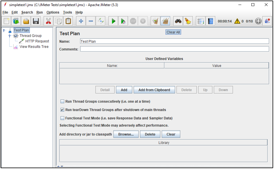

  • Click back on the Test Plan and save your project
    • File-->Save
      •       You will be prompted for a location to save your JMX file (your Test Plan)
      •       E.g., simpletest1.jmx

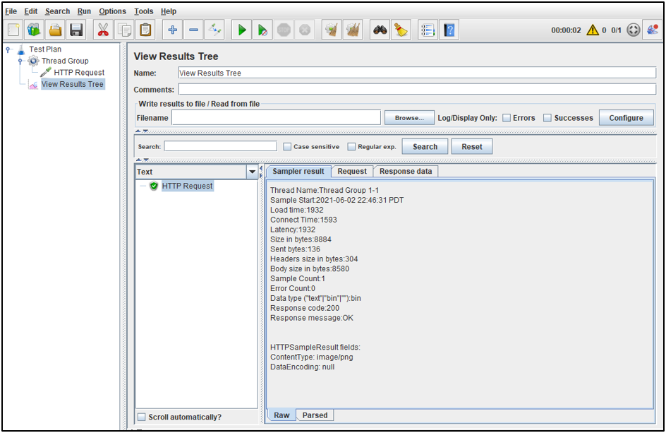

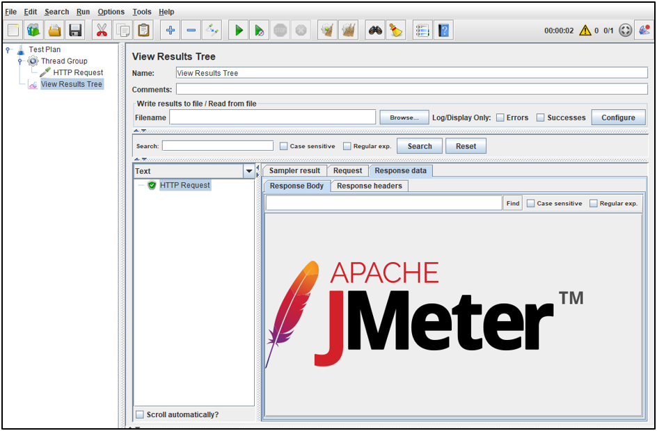

  • Visually validating a Test Plan can be easy thanks to the View Results Tree listener.

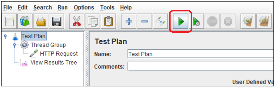

    • Simply click on the green triangle at the top of the Apache JMeter GUI, then select View Results Tree
  • This will just send only one request for the image we specified, then stop the test
    • This is by design with the default configuration of the “Thread Group”
    • A green shield with the words “HTTP Request” should be observed in the Text section
      • The “green” denotes a successful request and response
Note: Sending only one request helps prevent the "load testing" of the jmeter.apache.org site, which should be avoided.
  • Clicking on the green shield or HTTP Request, followed by Sampler result will show some key information by the remote server
    • Load time (response time)
    • Size in bytes (Header and Body)
    • Error Count
    • Response code
    • ContentType
  • Clicking on the green shield or HTTP Request, followed by Response data then Response Body will show the payload returned by the remote server
  • Clicking on the green triangle again will send another, single request for the same image
    • The Load time for the requested image will most likely be different
