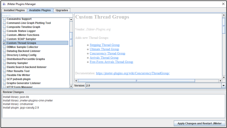

That said, using the JMeter Plugins Manager (installed as part of the Performance Testing with Apache JMeter (An Introduction)) to add the “Custom Thread Groups” can provide the test environment with some other useful options in this arena.
Adding Support for Custom Thread Groups into JMeter
From the Plugins Manager within JMeter (Options-->Plugins Manager):
  • Select Available Plugins
  • Find and select Custom Threads Groups
  • Select Apply Changes and Restart JMeter
Once the “Custom Thread Groups” plugin is installed, a recommended alternative over Thread Group is the bzm – Concurrency Thread Group as it allows for a straight-forward step configuration that visually renders the defined pressure which is a great validation feature from a testing point of view.

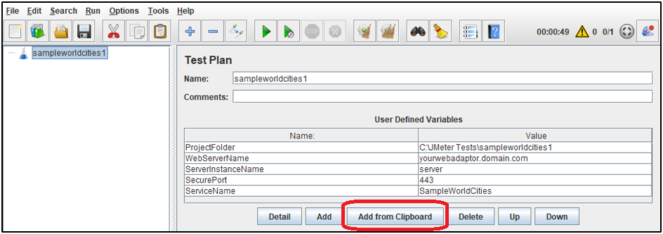

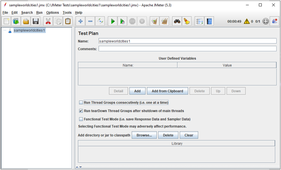

Adding Variables to the Test Plan
  • From within JMeter, click on the Test Plan (e.g. sampleworldcities1)
  • At the bottom of the User Defined Variables Section, click Add
    • For Name enter: ProjectFolder
      • For Value enter: C:\JMeter Tests\sampleworldcities1
    • For Name enter: WebServerName
      • For Value enter: yourwebadaptor.domain.com
        • Enter the hostname of your Web Adaptor or ArcGIS Server
    • For Name enter: ServerInstanceName
      • For Value enter: server
        • Some deployments use a different value, e.g. arcgis
    • For Name enter: SecurePort
      • For Value enter: 443
        • If pointing to an ArcGIS Server instance, use 6443
    • For Name enter: ServiceName
      • For Value enter: SampleWorldCities

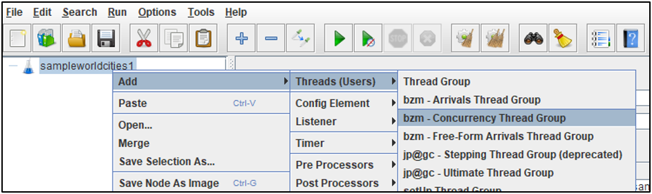

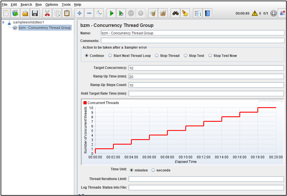

Adding the bzm – Concurrency Thread Group to the Test Plan
  • Right click on the sampleworldcities1 Test Plan and under Add-->Threads (Users), select bzm – Concurrency Thread Group
  • Under the sampleworldcities1 Test Plan, click on bzm – Concurrency Thread Group
  • Configure the step load logic with the following:
    • Target Concurrency: 10
    • Ramp Up Time (min): 20
    • Ramp-Up Steps Counter: 10
With the bzm – Concurrency Thread Group plugin, the configured step load logic can be easily seen and visually confirmed in the chart graphic above. This test will be set to run for 20 minutes, will increase pressure by using 10 different steps (adding 1 concurrent test thread at a time every 2 minutes), hit a maximum of 10 concurrent test threads then will stop.

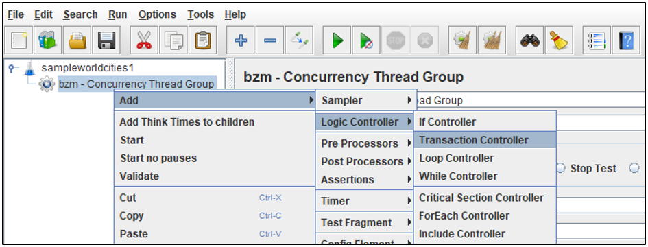

Adding a Transaction to a Test Plan
  • Right-click on bzm – Concurrency Thread Group and under Add-->Logic Controller, select Transaction Controller
  • Once added, give the Transaction Controller (e.g. the workflow operation) a meaningful name to distinguish it from others that may exist in the test
  • For the name enter: MapScale_9M
    • The 9M represents the map scale of 9 Million (e.g. 1: 9,244,649)
    • One or more HTTP Requests can now be added to this Transaction Controller
  • Select “Generate parent sample” from the Transaction Controller section
    • This option can assist with validation as it displays the respective requests under the Transaction object

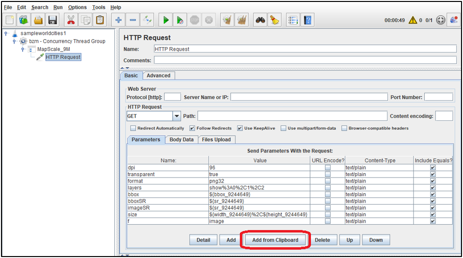

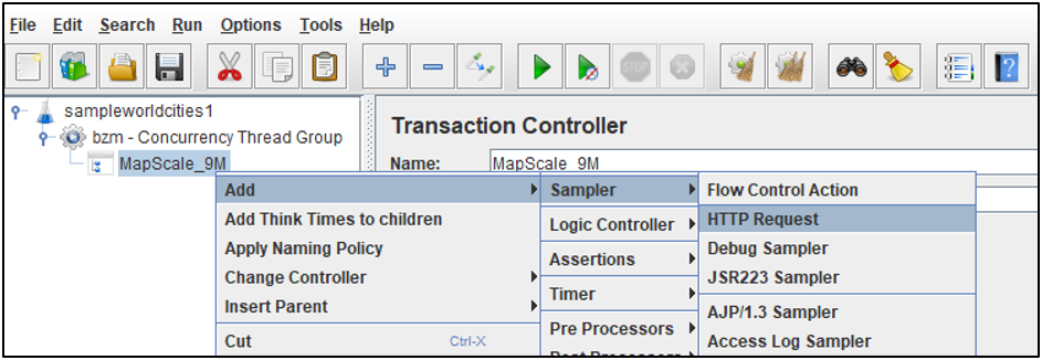

Adding an HTTP Request
Now we want to create a data driven HTTP request that will ask for a different spatial extent with each request. This is done with a regular JMeter HTTP Request.
  • Right click on the Transaction Controller called MapScale_9M, and under Add-->Sampler, select HTTP Request
  •  The new, empty HTTP Request should resemble the following:
Making the HTTP Request Dynamic
A request signature for export map such as:
https://yourwebadaptor.domain.com/server/rest/services/SampleWorldCities/MapServer/export?dpi=96&transparent=true&format=png32&layers=show%3A0%2C1%2C2&bbox=-108.76228873935%2C31.0409016308382%2C-88.8526618315487%2C46.9686031570791&bboxSR=4326&imageSR=4326&size=1477%2C827&f=image
contains several URL components that need to go to different places on the HTTP Request page (to maximize flexibility and maintenance). Let’s start with the key/value pairs of the request by separating the URL parameters.
Below the parameters section has been modified to contain several JMeter variables instead of the original values. It is okay that some parts will reference JMeter variable names that have not yet created in the test.
  • Copy the following and paste it into the HTTP Request by clicking Add from Clipboard at the bottom:
dpi=96&transparent=true&format=png32&layers=show%3A0%2C1%2C2&bbox=${bbox_9244649}&bboxSR=${sr_9244649}&imageSR=${sr_9244649}&size=${width_9244649}%2C${height_9244649}&f=image
This will help put in place several pieces necessary to make certain parts of the HTTP Request dynamic.

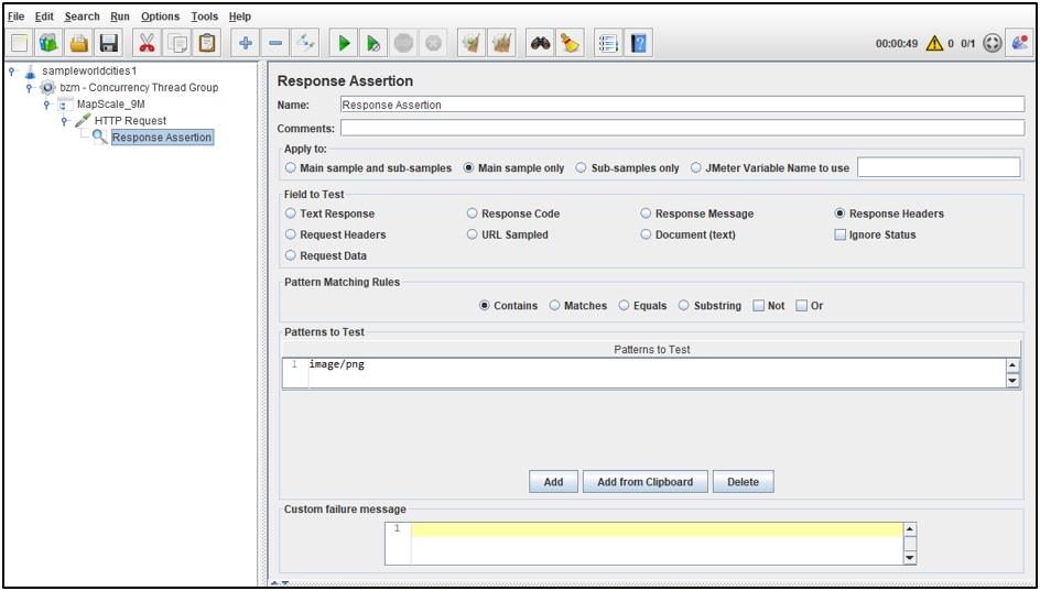

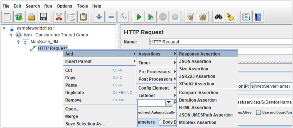

Adding a Response Assertion
  • Right click on the HTTP Request, and under Add-->Assertions, select Response Assertion
  • Change several of the Response Assertion parameters:
    • Under Field to Test, select: Response Headers
    • Under Pattern Matching Rules select: Contains
    • Under Patterns to Test, click Add and enter: image/png

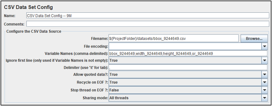

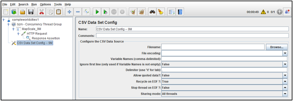

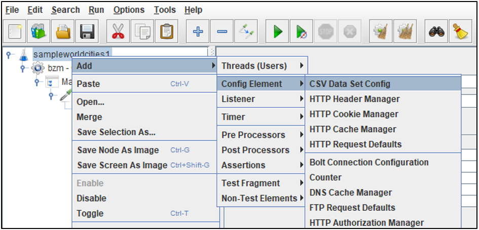

Adding a CSV Data Set Config
  • Right click on the Test Plan (e.g. sampleworldcities1), and under Add-->Config Element, select CSV Data Set Config
  • Select the CSV Data Set Config and rename it to CSV Data Set Config -- 9M
    • Providing a unique name can assist with maintenance/management if multiple data files are used within a test (e.g. one file for bounding box of each map scale)
  • Using a text editor, populate an empty CSV file with the following 16 lines of data:
bbox,width,height,mapUnits,sr,scale
"-108.76228873935,31.0409016308382,-88.8526618315487,46.9686031570791",1280,1024,esriDecimalDegrees,4326,9244649
"23.1282001284589,34.337748761293,43.03782703626,50.2654502875339",1280,1024,esriDecimalDegrees,4326,9244649
"-117.052786808947,35.3545948648786,-97.1431599011459,51.2822963911194",1280,1024,esriDecimalDegrees,4326,9244649
"-100.83549484975,36.0637839078502,-80.9258679419492,51.991485434091",1280,1024,esriDecimalDegrees,4326,9244649
"17.7030587822399,34.3302705716379,37.6126856900409,50.2579720978788",1280,1024,esriDecimalDegrees,4326,9244649
"32.2827904735659,37.2792197897781,52.192417381367,53.2069213160189",1280,1024,esriDecimalDegrees,4326,9244649
"0.222469446585188,35.0562794764081,20.1320963543862,50.9839810026489",1280,1024,esriDecimalDegrees,4326,9244649
"100.262489726575,20.8660021309943,120.172116634376,36.7937036572352",1280,1024,esriDecimalDegrees,4326,9244649
"72.4186084471192,22.1748804724666,92.3282353549203,38.1025819987075",1280,1024,esriDecimalDegrees,4326,9244649
"-61.2094273153097,-26.7402777397378,-41.2998004075086,-10.812576213497",1280,1024,esriDecimalDegrees,4326,9244649
"-72.5908131920005,-26.6270515481087,-52.6811862841995,-10.6993500218679",1280,1024,esriDecimalDegrees,4326,9244649
"99.7474167083529,20.7088254145549,119.657043616154,36.6365269407958",1280,1024,esriDecimalDegrees,4326,9244649
"102.59837658124,20.384726879328,122.508003489041,36.3124284055689",1280,1024,esriDecimalDegrees,4326,9244649
"80.8239612278688,23.4521454643548,100.73358813567,39.3798469905956",1280,1024,esriDecimalDegrees,4326,9244649
"-105.812716128284,31.0536390717042,-85.9030892204829,46.9813405979451",1280,1024,esriDecimalDegrees,4326,9244649
  • Save the CSV file to: C:\JMeter Tests\sampleworldcities1\datasets\bbox_9244649.csv
  • From the CSV Data Set Config window, Click Browse and navigate the bbox_9244649.csv file that was just saved
  • Configure several items of the data source:
    • Change Filename from: C:/JMeter Tests/sampleworldcities1/datasets/bbox_9244649.csv
      • To: ${ProjectFolder}/datasets/bbox_9244649.csv
    • For Variable Names add: bbox_9244649,width_9244649,height_9244649,sr_9244649
    • Change Ignore first line
      • To: True
    • Change Allow quoted data?
      • To: True

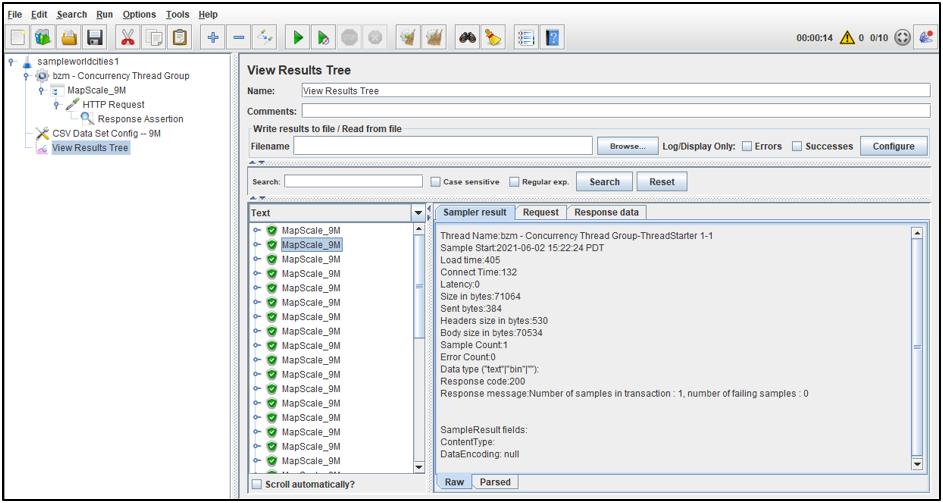

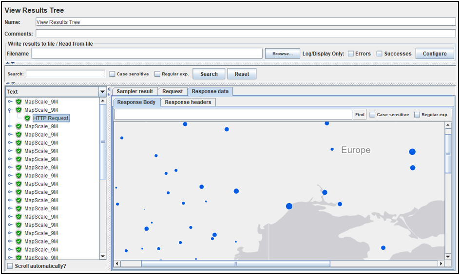

Validating the Test Plan

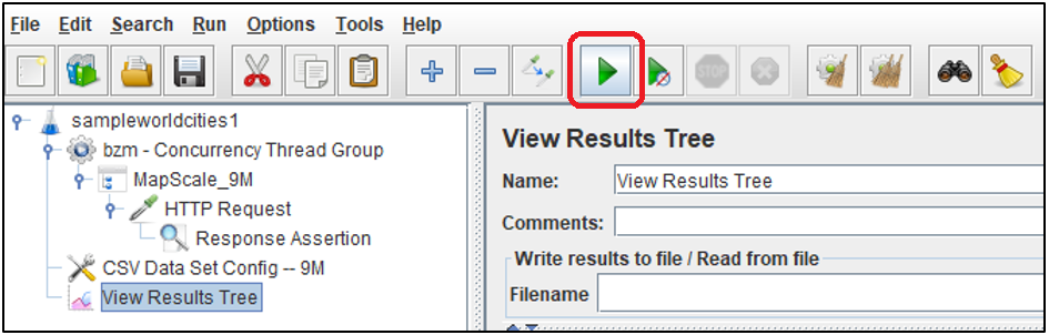

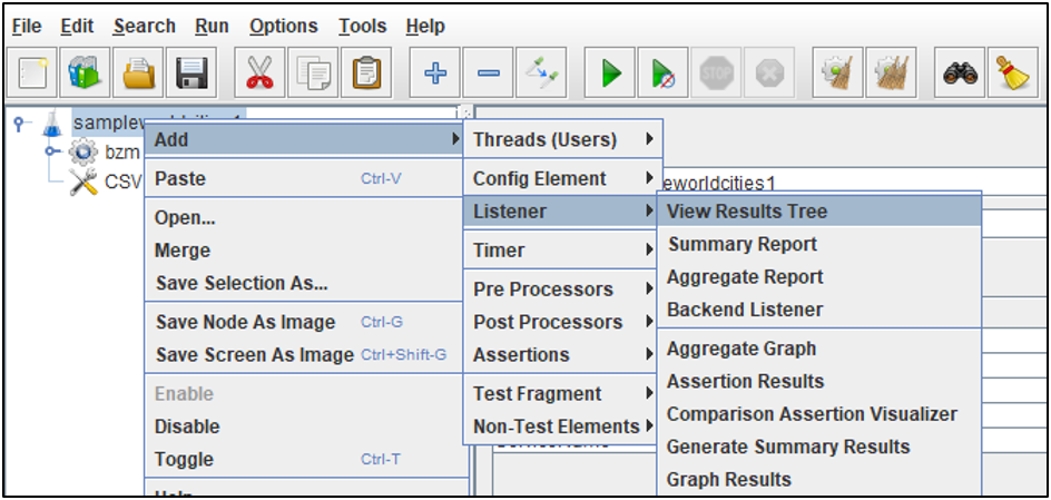

  • Use the View Results Tree listener to assist with validating the response in the GUI from the remote server
    • Right click on the Test Plan (sampleworldcities1) and under Add-->Listener, select View Results Tree
  • Select View Results Tree, then Click on the green triangle at the top of the Apache JMeter GUI
  • Following the configured step load, JMeter will start by repeatedly sending requests, (initially) one at time.
    • The green shield with a checkmark is a sign of a successful request, if this is seen, wait several seconds for a handful of requests to be sent and responses to be returned.
    • Clicking on one of the MapScale_9M green shields will show the Sampler result tab which displays information such as:
      • Load time (response time)
      • Size in bytes (Header and Body)
      • Error Count
      • Response code
      • ContentType
Note: This info is great for validating the test playback but also useful for performance troubleshooting

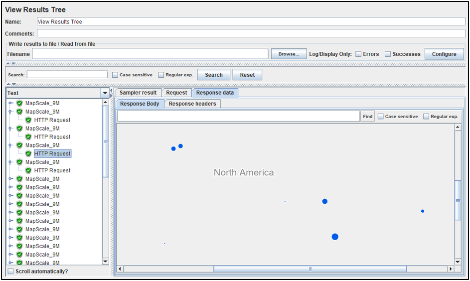

  • Since this test is exercising the export map function, a visualization of the requested image would also assist with the Test Plan validation.
    • Clicking the Response data tab and expanding the MapScale_9M transaction should render the requested image.
      • Repeat as needed for other MapScale_9M transactions
    • Toggling through several of the requests should show different images which validates the creation of a data driven export map load test in JMeter
