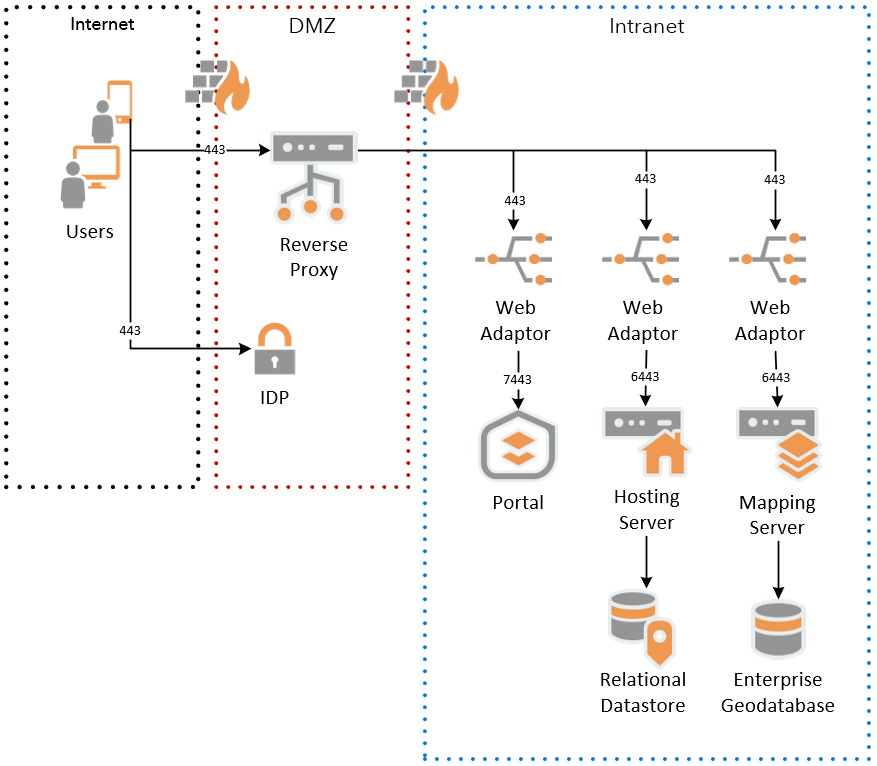

DMZ Reverse Proxy
Let’s begin with the most common external facing ArcGIS Enterprise system deployment pattern, using a reverse proxy in the DMZ.
Figure 1 - DMZ Reverse Proxy
In this pattern, all ArcGIS Enterprise components are hosted in the internal network, behind the firewall, and a reverse proxy (this can be a commercial reverse proxy, such as F5 or NetScaler, open-source reverse proxy such as Nginx or HAProxy, or a second set of ArcGIS Web Adaptors), is deployed in the DMZ, and passes external requests to ArcGIS Enterprise.
ArcGIS Enterprise portal supports only one DNS for public portal URL (the web context URL), and to support external access, an externally resolvable DNS name for the portal’s web context URL, e.g. https://gis.company.com/portal, must be used.
In most cases, the pattern above will include implementation of a Split Domain Name System (Split DNS), i.e. internal requests to ArcGIS Enterprise DNS (e.g. gis.company.com) will be resolved to the internal web adaptors machine IP, so internal users will stay behind the firewall, and external requests to ArcGIS Enterprise DNS will be resolved to the DMZ reverse proxy IP.
Using a Web Application Firewall (WAF) in front of the DMZ reverse proxy is a security best practice, as it adds additional security controls. Esri maintains a document (organizational login is required) in https://trust.arcgis.com with list of endpoints which may be safely filtered from external access to deny external access to potentially sensitive resources in your ArcGIS Enterprise site.

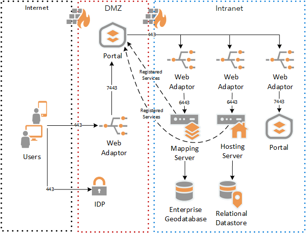

DMZ ArcGIS Enterprise Portal and Registered Services
Figure 2 - ArcGIS Enterprise Portal Proxy
In figure 2 above, there is an ArcGIS Enterprise portal in the DMZ, and an ArcGIS Enterprise server in the internal network. The internal standalone server is not federated with portal – services are published directly to the standalone server, configured as secured in server using an application account (ArcGIS Enterprise server built-in application account or Active Directory / LDAP service account), and then added to portal as items from the web with stored credentials. When ArcGIS Enterprise server secured service is registered in portal with stored credentials, portal creates a proxy URL for that service, and all requests to that service will go through portal before they are forwarded to the internal standalone Server. ArcGIS Enterprise portal also allows you to define rate limit and specific referrers that can access the service.
Using the above pattern meets the constraint of no unauthenticated access to the internal network, as all external requests must pass through the portal in the DMZ, which will first authenticate and authorize the user, and only then make a request to the service in the internal network. Be aware that since all requests from portal to server are done using the stored credentials, you lose the editor tracking capability.
The architecture in this pattern can be elaborated to include an internal-facing federated system of ArcGIS Enterprise with portal, hosting server, and federated server(s), as depicted in figure 3.
Figure 3 - ArcGIS Enterprise Portal Proxy Elaborated

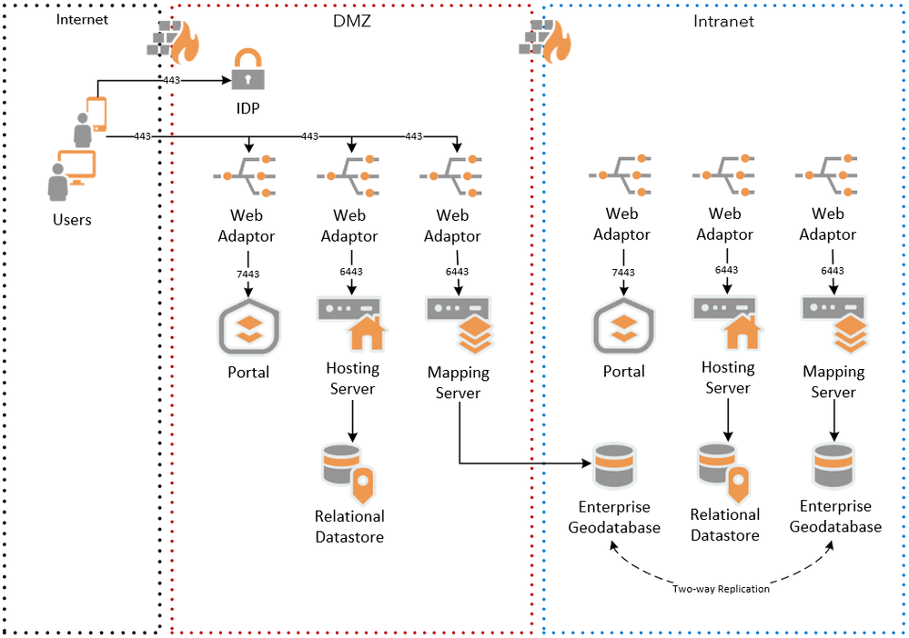

Internal Replicated Geodatabase
Some organizations’ security policies do not allow HTTPS access from the DMZ to the intranet, and only allow database access, usually via non-default ports, and in many cases also do not allow external access to a primary production database, and require the usage of a separate database.
In figure 4 below, ArcGIS Enterprise is deployed to the DMZ, and an internal replicated enterprise geodatabase is used as registered data source for the mapping server. Either Esri geodatabase replication or RDBMS replication can be used.
Figure 4 - Database Replication

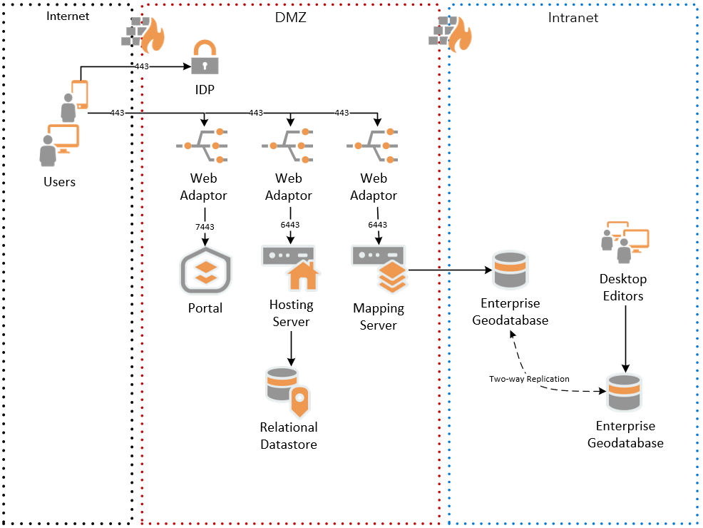

Figure 5 below presents an elaborated architecture which includes internal-facing ArcGIS Enterprise system in the internal network and an external-facing ArcGIS Enterprise system in the DMZ.
Figure 5 - Database Replication Elaborated

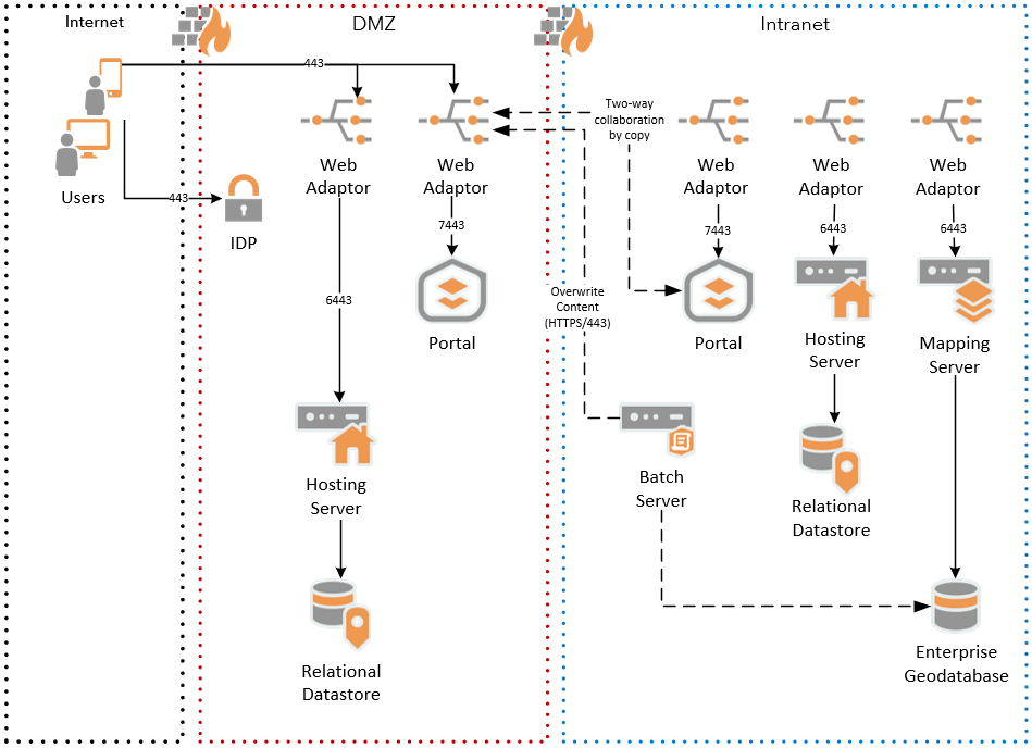

Service Publication and Collaboration
Finally, for those who do not allow any inbound access from the DMZ to the intranet, figure 6 below depicts an external-facing ArcGIS Enterprise in the DMZ, and an internal-facing ArcGIS Enterprise in the intranet, with:
  1. Services published to the DMZ ArcGIS Enterprise system as hosted layers, and automated tasks running on a schedule (e.g. nightly or weekly) to overwrite the hosted data with updated data from the internal ArcGIS Enterprise system
  2. Feature layers are shared by copy from the internal ArcGIS Enterprise system to the DMZ ArcGIS Enterprise system via distributed collaboration with two-way shared editing (introduced at version 10.9)
Figure 6 - Service Publication and Collaboration

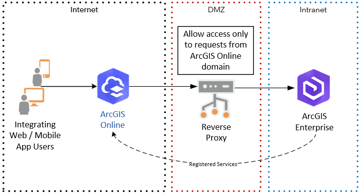

ArcGIS Online Proxy
Similar to the DMZ ArcGIS Enterprise Portal and Registered Services pattern (figure 2 above), ArcGIS Online also acts as a proxy when you register secured services from either standalone ArcGIS Enterprise server or from federated ArcGIS Enterprise system. In Figure 7 below, services from an internal ArcGIS Enterprise system are registered in ArcGIS Online with stored credentials, ArcGIS Online can access the services via the DMZ reverse proxy, and the reverse proxy is configured to allow requests only from ArcGIS Online domain, blocking requests from any other sources. The integrating system web or mobile app can be registered with ArcGIS Online using OAuth 2.0 and ArcGIS Identity, so only authenticated and authorized users can access the registered services. Since ArcGIS Online will access the services using the stored credentials, editor tracking will not work. Similar to portal, you can define rate limit and specific referrers that can access the services.
Figure 7 - ArcGIS Online and Registered Services

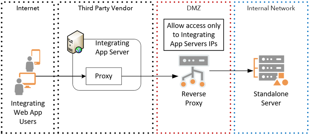

Server Proxy
Another approach would be to use a standalone ArcGIS Enterprise server site and a server proxy to access secured services from an integrating web app.
In figure 8 below, integrating system web app clients are configured to send GIS requests to a proxy, hosted on the integrating system application server. The integrating application server is responsible to secure access to the proxy, i.e. allow only app-authenticated users to access the proxy, and to protect (encrypt) the ArcGIS Enterprise server credentials. The proxy handles the ArcGIS Enterprise server token security on behalf of the client, using a server built-in application account or an Active Directory / LDAP service account, and sends the request to the internal standalone ArcGIS Enterprise server site via the DMZ reverse proxy. The reverse proxy is configured to allow requests only from the integrating app server(s) IPs (list or range), blocking requests from any other sources.
Figure 8 - Integrating Web App Server Proxy

We are currently working on setting up the ArcGIS Online Proxy setup (Fig. 7), but can't seem to find information on which domains to limit access to. In your article you write : "ArcGIS Online can access the services via the DMZ reverse proxy, and the reverse proxy is configured to allow requests only from ArcGIS Online domain, blocking requests from any other sources."
Where do I find the documentation for what the "arcgis online domain" consists of, specifically with regards to registered services?
Thanks in advance.
/Martin
NoahMayer
Hi @MartinWennerwald1!
Esri is maintaining an ArcGIS Online domain requirements document in ArcGIS Trust Center.  There are tow versions of the document:
Public document (less detailed): https://trust.arcgis.com/en/documents/AGOL_Domain_Requirements.pdf
Customer Accessible Document (more detailed, requires login): https://trust.arcgis.com/en/customer-documents/ArcGIS%20Online%20FQDN%20Requirements%20V1.8%20June%2...

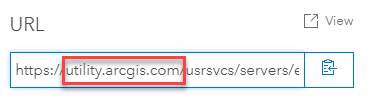

This document is intended mainly for a forward proxy, to allow users to access ArcGIS Online resources, so you can see the list beyond what's required for setting up the ArcGIS Online Proxy (Fig. 7).
What I would recommend is to view the service URL in the portal item which is created for the registered services, this URL is the proxy URL, and allow only the FQDNs which are used for the proxy:

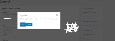

I removed user and group store configurations as I'm using SAML authentication. as I mentioned earlier, It is federated with server,
Service URL
Administration URL
as per old configurations, I did not change anything and anywhere except WebContextURL in arcgis portal admin.all are pointing to internal domain reference.
For above Server Configurations Do I need provide DNS  alias or internal domain ?
Every time, I click on Organization tab in ArcGIS Portal, it displays a dialog to sign in. can we bypass this ?  after clicking ok, it automatically signed in.
We have a Web application and in that, all map services are pointing to <internal domain>/rest/services/<Service Name>/MapServer. Do I need to change all map services URLs to DNS alias  instead of internal domain that we were using till now?
Thanks
NoahMayer
@vijaybadugu,
Portal for ArcGIS does not support changing/setting the WebContextURL for an existing ArcGIS Enterprise system that has content, because all the original items have the old, internal domain URLs, and all those will have to be updated to the new DNS alias.
The Services URL in the federation will have to be updated with the new DNS alias because this is how all users will access the services. External users will not be able to resolve your internal domain URLs.
I recommend you collaborate with Esri professional services to assist you with this process.

We are working on a design to facilitate an external-facing ArcGIS Enterprise to enable field crews to connect and share data via collaboration with external government agencies.
We were considering the architecture provided in Figure 5 of the document you mentioned. Our architecture team suggested placing the replicated geodatabase in the DMZ via port 1521 and running nightly replication instead of hosting it in the corporate network. We are using Oracle database, so allowing port 1521 or any other custom port to let replication work. Noting data is 24 hour delay to external ArcGIS instance.
Could you please advise on the issues associated with having a replicated Oracle database in the DMZ and enabling ArcGIS replication? Is allowing two-way replication a threat? One suggestion is to enable only one-way replication from the internal geodatabase to the external database in the DMZ and to write ETL scripts (FME) to fetch the data from the external database.
ArcGIS Enterprise 10.9.1
Oracle DB - 19c
NoahMayer
Dear @GeoExplorer ,
What are the concerns you have regarding using a two-way replication? In general I would prefer to use geodatabase replication over ETL where available, since geodatabase replication has a robust set of capabilities, such as viewing and resolving conflicts, which might be very challenging with ETL. Depending on the concerns you have, you might opt-in to use disconnected replication instead of connected replication.
GeoExplorer
Occasional Explorer
Dear @NoahMayer,
Thank you for your response.
Cyber Security team in our Organisation has put two-way replication on hold, mentioning no communication from database in DMZ to corporate database network. But approved using one-way replication from corporate database to database in DMZ, which is disconnected replication that is batched to sync overnight.
Do you reckon it is really a problem/threat in enabling two-way replication as compared to One-way replication via custom port (1521)? Suggestion from the cyber security team is to write ETL scripts to bring down the necessary data collected by field users from the DMZ database to the corporate database.
DavidHoy
Hi @GeoExplorer
it would be possible to have 2-way geodatabase replication using a geodata service running on the internal ArcGIS Server. This would only require 443 access through the internal firewall. The synchronisation would be triggered by a python script running on the Server in the DMZ. The python script would require a geodatabase connection (via Oracle client) to the DMZ Geodatabase but a geodata service connection to the "master"geodatabase within the secure network.
NoahMayer
@GeoExplorer
I'm not in a position to say if a two-way replication is more of a problem/threat compared to a one-way replication from corporate database to the database in DMZ and ETL from the database in the DMZ to the corporate database. This is up to your security team to decide. If they have specific questions regarding how the Esri software works, or if they are willing to share their concerns, Esri PS can try to answer their questions and help them with their decisions.

@NoahMayer These are my findings on ArcGIS Online <-> ArcGIS Enterprise Communication:
ArcGIS Online {subscription}.maps.arcgis.com will try to access
machinename.example.com/server/...
and
machinename.example.com/portal/...
Communication is initiated by {subscription}.maps.arcgis.com
and another remoteaddress {someipaddress}:443 (is it a fixed or dynamic IP? generic for ArcGIS Online or specific to subscription?)
requesting access to the internal machinename.example.com server/portal endpoints.
Communication is done using HTTPS: GET, HEAD, POST, OPTIONS
NoahMayer
Related to the remote address {someipaddress}:443 requesting access to the internal endpoints: ArcGIS Online uses dynamic IPs, but you should not see requests coming from ArcGIS Online using IP address. Can you test allowing access only from {subscription}.maps.arcgis.com and see if it allows access via the ArcGIS Online proxy?
DavidHoy
If you were allowing CORS requests to your Portal from AGOL,
you would add the following to your AllowedOrigins
  1. https://www.arcgis.com
  2. https://<your-organization>.maps.arcgis.com
perhaps both these should be allowed and included in the list of URLs allowed to access your proxied service?
