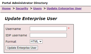

This IWA to SAML migration is something we've seen quite a bit of, and there is a way to map an existing IWA created user to enable a SAML login without recreating users via :
Update Enterprise User—ArcGIS REST APIs | ArcGIS Developers
This operation allows an administrator to update the idpUsername for an enterprise user in the portal. This is used when migrating from accounts used with web-tier authentication to SAML authentication.
Users are then able to login to existing accounts with a SAML IdP login.
This is best run against all users in batch via a script if you have a large number of users.

DavidHoy
Hi Dean -
I presume this keeps the internal user identifier, so content ownership and group membership would remain unaffected.
But does the username shown in the Profile and Item ownership say remain unchanged (i.e. is the IDP username effectively an Alias - only used when authenticating?)
DavidHoy
ok - I just did some testing in my sandbox
username does not change - just the property called IDPUsername
content is still owned by the original username
I confirmed by looking in the portal/sharing/rest/community/users/<username> directory where these properties are listed
DeanMoiler
Hi David,
Yes that's correct. Only IDPUsername attribute is updated which allows SAML login if web authentication is disabled. Original username remains unchanged.
