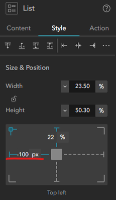

Negative Pixels (Any Version)
One last option in that Style Tab is to click on that crosshair thing, set it to px and put in an absolute value big negative number, like -1000px, and watch as your Widget flies off the screen.
This is probably the best choice on the Style Tab, but maybe your Widget will re-appear on one of those huge curved monitors that are becoming increasingly popular. And again, I suspect this won't work great with a screen reader.

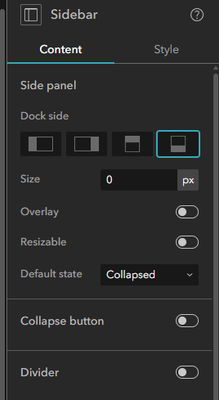

Sidebar Widget (Any Version)
Alright, we've done this one before...
Get a Sidebar Widget and put your hidden Widget in the Collapsible Side. Set the Size to 0px, turn off Resizable, set Default State to Collapsed and turn off the Collapse Button. Your Widget is now hidden in an unopenable Sidebar. If screen readers try to read this, we have a big problem.
