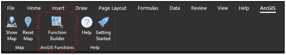

Traditional Formulas versus the ArcGIS Function Builder
Traditional functions or formulas are equations you type directly into an Excel cell. These work well for shorter formulas, but longer ones, or those that require inserting parameters from different Excel worksheets, can become complicated. You must type the syntax perfectly or the formula won’t work (i.e., using quotation marks around words, separating parameters with commas). One way to make the user experience friendlier for ArcGIS functions is using the built-in function builder under the ArcGIS tab in Excel.
Tip: For instructions on how to download the ArcGIS for Excel add-in, see my previous post or visit the Get ArcGIS for Excel Help documentation.
The function builder allows you to enter the parameters for the function without worrying about the formula’s syntax being correct. You can type in the cell numbers and choose options from pick lists of available parameters to build your function.

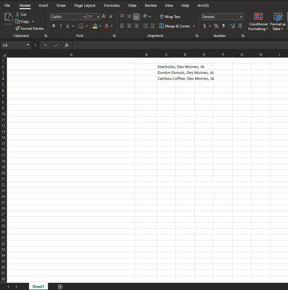

To do this, open a blank Excel sheet and type the name, city, and state of the three competitors into separate cells (i.e., Store 1, City, State).

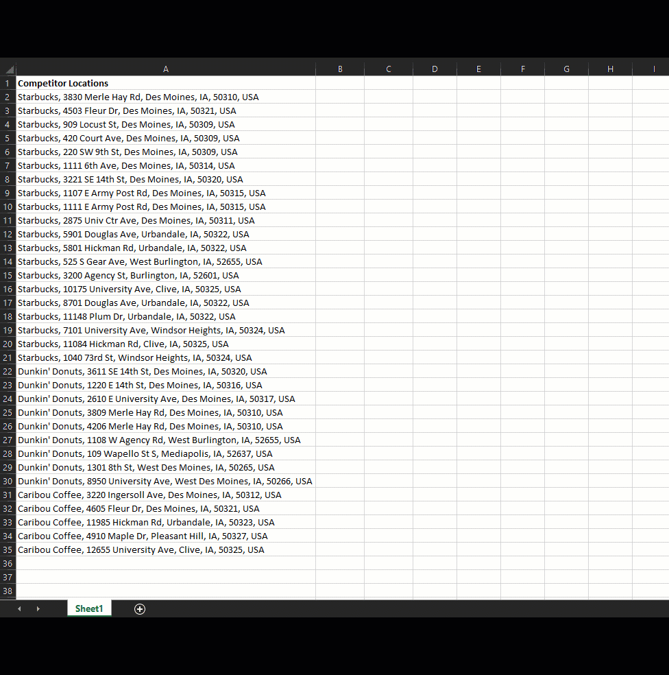

Now, use the text in these cells in an =arcgis.suggestaddress formula (as shown below) to search for the addresses of these stores.
The formula used to generate the addresses looks something like this:
=ARCGIS.SUGGESTADDRESS(C2, 100). 100 corresponds to the maximum suggestions parameter to limit the number of search results returned. Note that if you don’t enter a number for this parameter, the function will return only 5 results by default to limit the number of credits used.
Tip: Copy and Paste123 the cells into a new column or sheet to separate the values from the array that the formula automatically groups them into.
Perform your own QC
Next, you’ll need to perform your own quality control (QC) on the results returned. For example, some of the results for one store returned addresses in Urbandale and Pleasant Hill, Iowa, technically outside the Des Moines, Iowa city limits in a nearby suburb. Do you want to include this data in your competitor analysis? It’s up to you to decide.

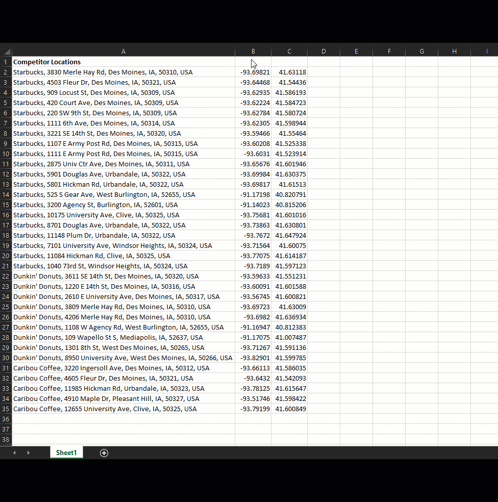

Put places on a map using the =arcgis.getcoordinates function
Next, you want to turn these rows in the Excel sheet into places you can put on a map. There’s a function for that!
I’ll delete the contents of the cells where the store name, city, and state were typed and click on cell B2 to begin generating the longitude and latitude coordinates for the addresses in our new list.
Then, I’ll start with =ARCGIS.GETCOORDINATES(A2) to get the coordinates for the address in cell A2. This generates the longitude and latitude coordinates for that address in column B and C respectively. Then, simply drag the corner of the cell to the bottom of the list to automatically generate the coordinates for the rest of the list.
Add column headers using the =arcgis.addheaders function
Finally, you need to add some column headers to your coordinate columns so they can be geocoded. This one is extra simple and requires using =arcgis.addheaders in cell B1. The formula reads the data you just created and generates the column headers automatically.
