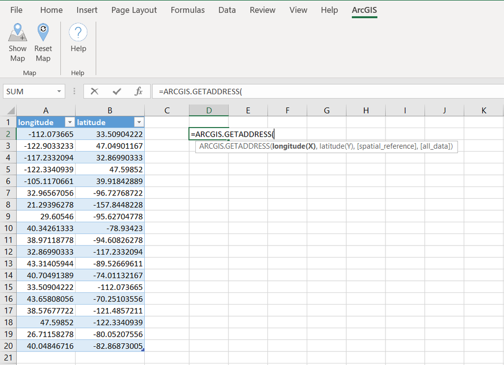

This function creates addresses from the XY location. To use this function, you have to type ‘=arcgis’ in the empty cell in your worksheet. The drop-down list will display a list of all the supported ArcGIS functions. From that drop-down list, select the ArcGIS.GETADDRESS function and function contains four longitude(X), latitude(Y), [spatial_reference], [all_data] parameters.
The first two, longitude and latitude, are mandatory parameters out of these four. All the optional parameters are in the square brackets. And for longitude and latitude parameters, enter the values manually or select cell references containing longitude and latitude values, and press enter. You will notice that addresses pertaining to longitude and latitude get added to the worksheet in the new column. To apply the function to the entire column, you have to select the cell where you have input the function, place the cursor on the bottom right corner, and drag the Fill handle tool to those cells where you want to apply the formula. You can also add a header to your ARCGIS.GETADDRESS function output. For that, you have to use another ArcGIS for Excel function – ‘ARCGIS.ADDHEADERS’. ARCGIS.ADDHEADERS function has only one mandatory parameter, and that refers to a cell reference to another ArcGIS Excel function. Go one row above the cell where you have input the ArcGIS.GETADDRESS function, type ‘=ARCGIS.ADDHEADERS’, and for the parameter, select the cell where you have inserted the ArcGIS.ADDRESS function. You will see the header is added to the newly added column, which was generated using ARCGIS.GETADDRESS function.

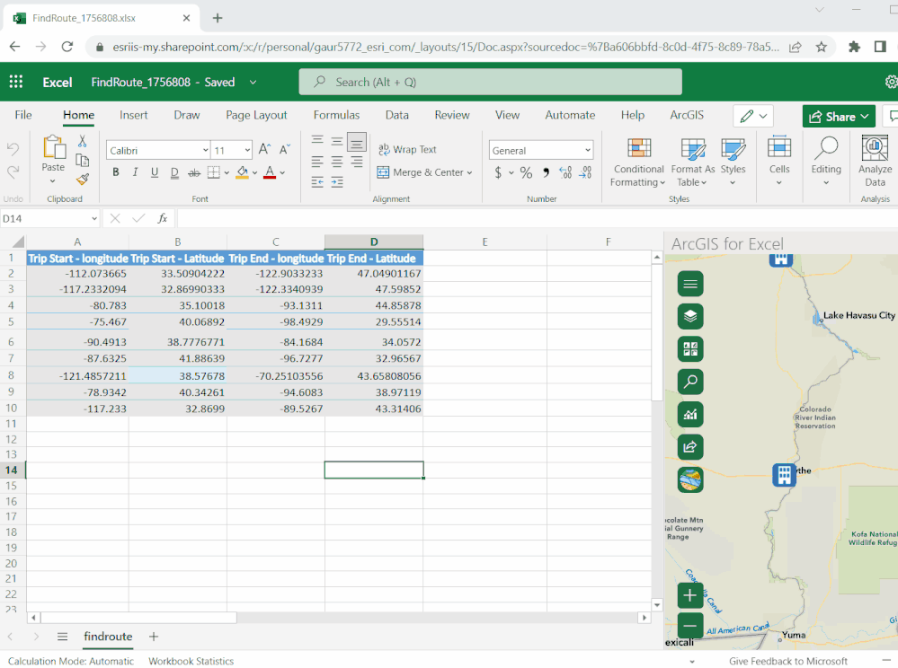

Interested in finding the total distance and time travel between the two XY locations, ARCGIS.FINDROUTE function is the way to go! In the function for the mandatory arguments, you have to pass the XY coordinates of the starting location of the route and XY coordinates of the destination location of the route. 
To find the total travel distance and time between the two addresses, use ARCGIS.FINDROUTEBADDRESS function.

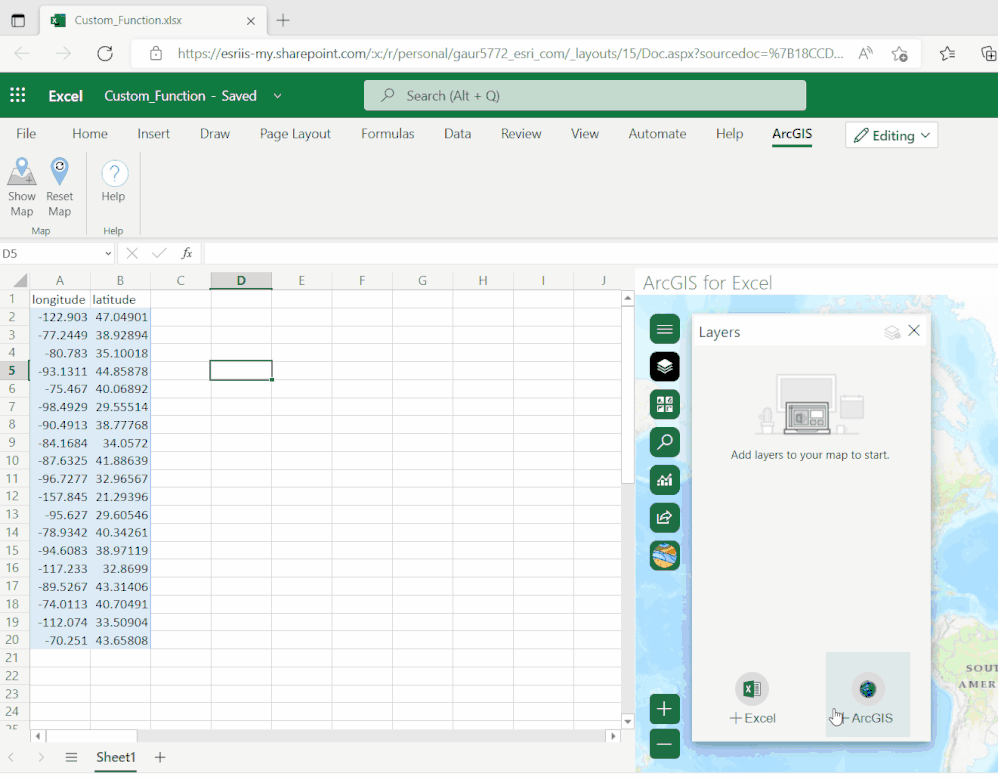

Much awaited request of adding a map in Excel in Web browsers is fulfilled in ArcGIS For Excel 2022.2 release. You can now add a map in Excel for Desktop and also in Excel Online. ArcGIS for Excel 2022.2 is supported in both Windows and Mac OS. Please try the 2022.2 release yourself and provide us your feedback in the ArcGIS for Excel community channel.
