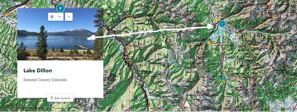

One of the easiest ways to map your photos is to create a Map Tour in a story map, as described here with one of my photos shown below. Another way is to use the Photos with Locations tool to quickly map a whole folder of photographs, as I describe here.

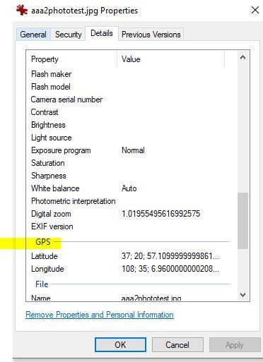

Can you check the photographs before you map them and thus know ahead of time? Yes, you can click on the images and access properties > details (on a PC, the procedures might be slightly different on a Mac). As shown below (for photograph #2 attached to this essay), the GPS latitude-longitude information is shown, roughly at 37 degrees north latitude and 108 degrees west longitude:

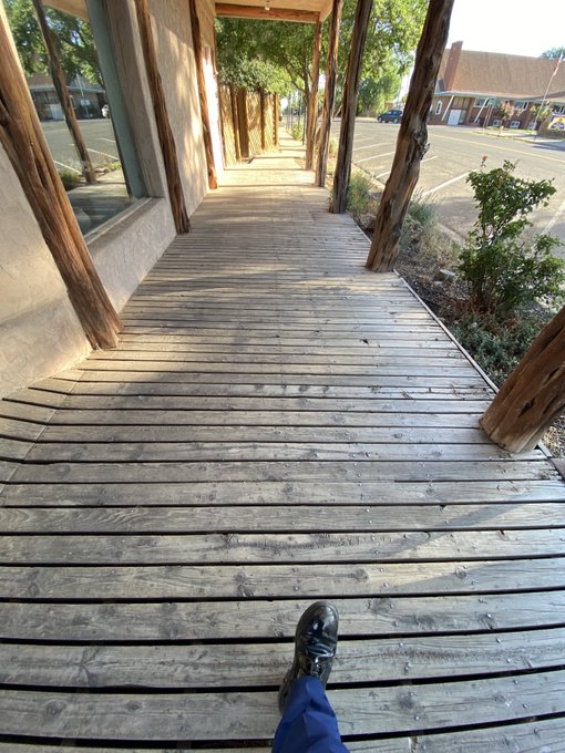

Attached to this essay are 5 versions of the same photograph that I took, for you to test them yourself if you would like. Each began as a single photograph with the location services turned on. I took the photograph in front of the Cortez Cultural Center (wonderful place for the inside portion of our institute!) but I used different methods to transfer the photo from my device (iPhone 11) to my computer (PC). Photo #1 (aaa1phototest) is one I emailed to myself from my phone's photo gallery using the default email client, which in my case I set up for gmail. The location information was lost upon my receipt of the email. Photo #2 is one that I emailed to myself from my phone's photo gallery using the Outlook mail client. In this case, the location information was retained. I sent photo #3 to myself not from the photo gallery but from my phone's Outlook mail client, and chose the photo as an attachment, but here, the location information was lost. Photo #4 is one I uploaded to a cloud drive (in this case, OneDrive), and downloaded to my local device, and the location information was retained. By the way, my photo in OneDrive was in .HEIC format. I wanted to map it so I converted it to .JPG, and the conversion thankfully did not remove the location information.
