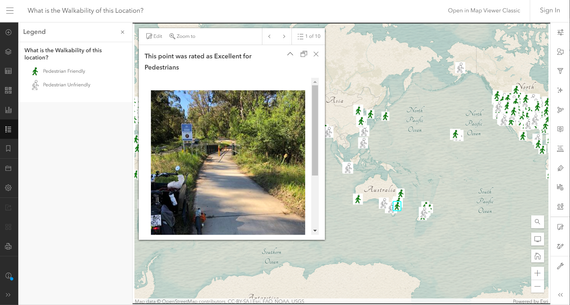

In my work with educators and students, I often use the most straightforward and easiest method of all--making an ArcGIS Online map from a feature service. The feature service, or "map layer", can be generated from a field investigation from ArcGIS Field Maps, ArcGIS Survey123, or ArcGIS QuickCapture, or even from manual input methods from a CSV or from a non-ArcGIS tool such as iNaturalist.  This involves simply accessing the feature service item page in ArcGIS Online, and in the upper right, specifying "open in map viewer".  Once in the map viewer, you can symbolize and classify the data, create popups, labels, and do other work designed to increase the engagement and readability of the map, and when done, save the results in an ArcGIS Online map.  This map can then be shared with your researchers, students, or even with those who are not a part of your project.  For example, here is a web map from one of my surveys, on walkability:
https://www.arcgis.com/apps/mapviewer/index.html?webmap=fd54348d6d784d6f9179fd7342e6b8f1
A portion of a web map in ArcGIS Online showing the results of a field investigation.

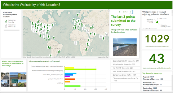

One of the most intriguing and again easily-implementable ways to display your field survey results is in a dashboard.  I frequently use dashboards to display field results with the added benefit of interactive maps, graphs, charts, a legend, graphics, and other elements that show the real-time status of the field investigation.  Below is an example of one of these from the same walkability survey that I mentioned:
https://www.arcgis.com/apps/dashboards/501bfe8b835745d4bd29a857a2bf32ba
A dashboard showing the results of a field investigation.
