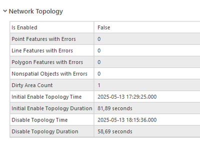

If I open network topology information on db I have the value one on Dirty area count.

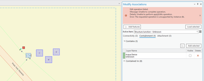

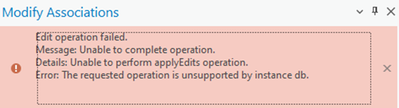

a)  Copy and Paste UtilityNetwork with an enabled network topology in on Oracle 19c.  This time, the topology works fine. Now, I can enable and disable the topology without issues. The ASSOCIATIONSTATUS  field is populate correctly for associations. Howerver, when I try to edit a structure junction container and add a content feature (using Modify association in ArcGIS Pro) the following error apper:

So the un solution work fine only in case C) but I need to work on Oracle (case A). What might be causing "Edit operation failed" issue?
