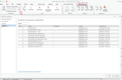

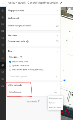

@GeoMon - This is a common error when the Utility Network isn't included in the Map.
Can you ensure that the "Utility Network" layer is included in the map that you publish from ArcGIS Pro.
A check to see if this has worked is to see the map properties in the MapViewer.  You should see a Utility Network.
Another thing to check is that when you publish the map from ArcGIS Pro make sure some trace configurations are shared.
