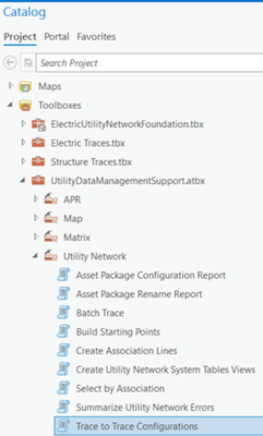

Trace to Trace Configuration GP Tool
Using ArcGIS Pro 2.9.x, in the core Utility Network Tools GP toolbox, there is no GP tool to import the results of a trace into a Named Trace Configuration.  However, there is an Esri downloadable python toolbox called, Utility Data Management Support tools, that provides functionality to import the results of a trace into a Named Trace Configuration along with many other useful tools.
Details and download directions for the Utility Data Management Support toolbox  are located here.

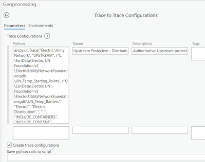

Upon adding the Utility Data Management Support toolbox to your ArcGIS Pro Project, you can use the “Trace to Trace Configuration” GP tool to take python syntax for a successful trace execution and create a new Named Trace Configuration.
Here is the workflow to create the Named Trace Configuration from trace results

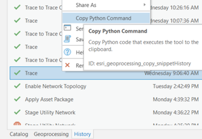

  1. Manually configure the Trace GP tool with the parameters you need and run the trace
  2. Open this History tab, right click on the Trace entry and select the “Copy Python Command"MichaelHirschheimer_0-1661800309755.pngMichaelHirschheimer_0-1661800309755.png
  3. Open the Trace to Trace configurations GP tool and paste the python command into the “Python” text box
  4. Enter a Trace Configuration Name and Description and hit the run button
  5. Note:  This screen shot was taken in March 2023.  You'll need to download the latest Utility Data Management Support toolbox if you are seeing an older version of this GP tool.

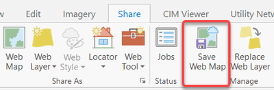

  5. To save the Web Map to portal: From Share Tab --> Save Web Map (in Manage group)
  6. Note:  The Save Web Map button is only enabled when a "linked" Web Map is the active map

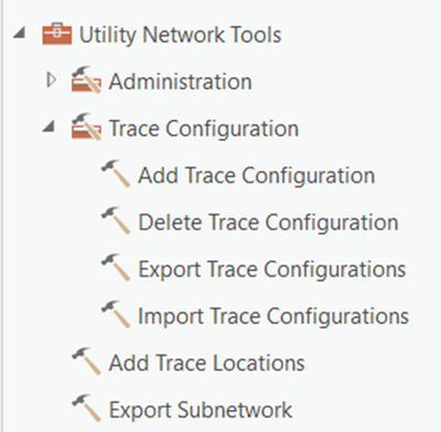

You may have noticed that the Trace Configuration toolbox doesn’t contain an Update tool.
There are currently no means to update any of the settings of the Named Trace Configuration from ArcGIS Pro.  The only option is to use the Trace Configuration REST API’s Alter command.

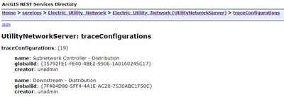

The Alter documentation informs us that the globalID parameter is required and that all others are parameters are optional.  To get the Trace Configuration Globalids, follow the path in the screenshot.

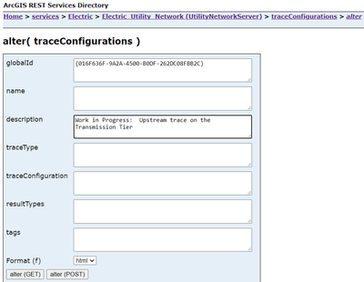

Using the screenshot below, when the alter (Post) button is clicked, the only attribute that will be updated is the description.
I’ve been using this REST API to update the descriptions and occasionally the name.
I avoided the traceConfiguration parameter as it is a complex JSON object.  Unless you are comfortable with JSON and Fiddler, I suggest creating a new Named Trace Configuration within ArcGIS Pro as opposed to updating the traceConfiguration from the REST API.
