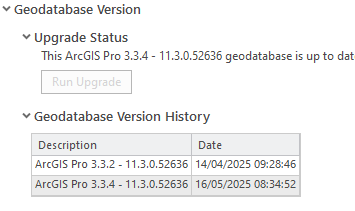

I did update geodatabase before starting to load Un data. The empty geodatabase has been created first time with 3.3.2 but I updated it using pro 3.3.5 and now it is:
Let'me know if I can verify other things.
