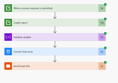

Bryan_Wade
Alison,
If I want to send that report in an email as part of the flow where would I put that in as part of my flow? Below is an image of how I inserted it but when I tested it I didn't get an email attachment.
