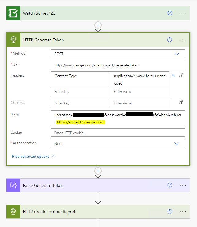

Thanks to James Tedrick at ESRI - the solution to the issue we were having generating reports using the Create Feature Report API in Microsoft Power Power Automate has been resolved. The issue was a bit difficult to diagnose, since everything worked as expected except when a geopoint question was included in the report template, then it could not render the map on the report and the process would timeout.
The solution is to make sure the generateToken API request in the flow includes the value referer=https://survey123.arcgis.com

I just finished a form that requires a map, so this is very good news indeed!

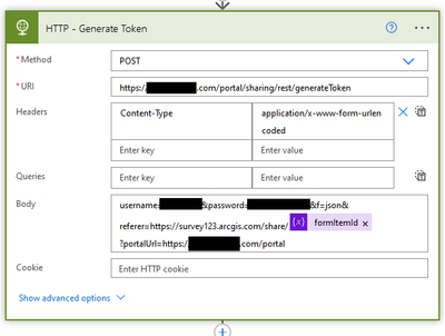

However, I feel like something may have changed behind the scenes with either Esri or Power Automate? When I went to check my set-up, I already had the referer set (also visible in my post above):
I did a test with my automation as-is, and the print (including a map) didn't time out! I'm very excited to have this capability again.
