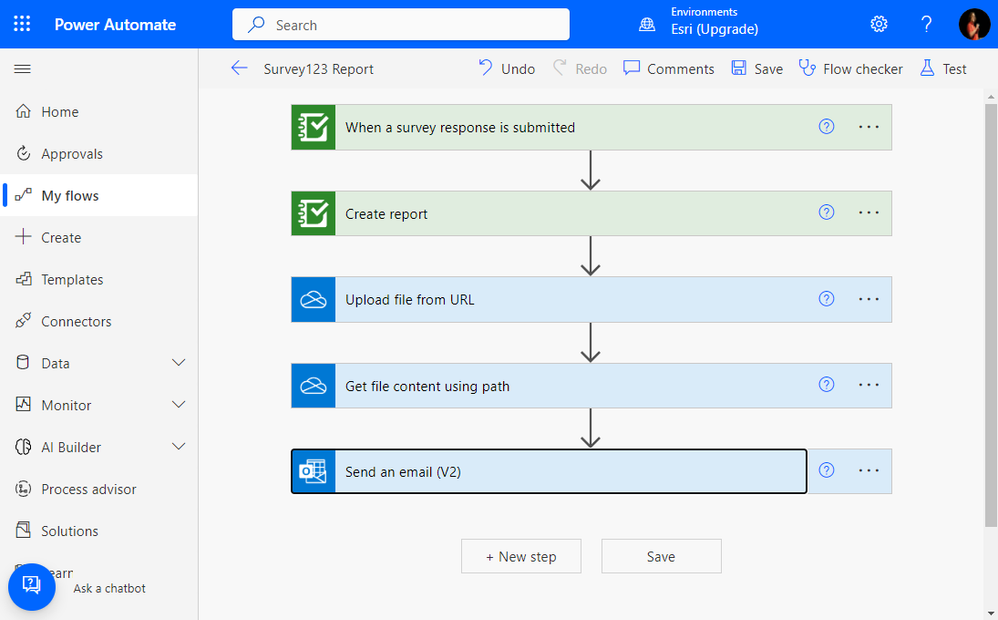

Hi @IsmaelChivite
Thank you for the useful guidance. I want to take the file and not save it into OneDrive, but instead, I want to send it to an email as an attachment. Would that be possible?
IsmaelChivite
Esri Notable Contributor

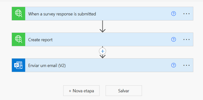

Thank you, Ismael! It worked for me! However, is there a way to send the report directly by email, without going through the one drive?
