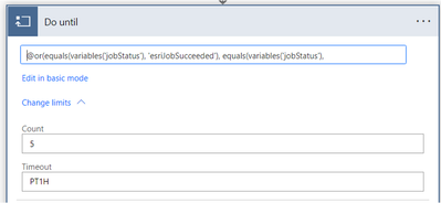

one query, there is count in "Do Until" how is that helps? can we reduce it to 10 or 5 ? Please advise.
thanks & best regards,
abureaux
MVP Frequent Contributor
Count: 60
Timeout: Leave as PT1H
Thanks for the reminder. I will update the guide with this.
Normally this doesn't take more than a few tries. But sometimes is can be slow. I found that 60 is a good number, and it hasn't resulted in any unwanted timeouts for me. You don't want to go too low because if the Survey123 server takes a little longer to respond, you could have the flow give up before a success. Also, having a larger number doesn't slow anything down. As soon as the loop sees a success, it ends and carries on to the next step.
