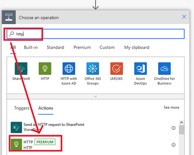

@abureaux Pardon my ignorance on this, but are the "Add an HTTP" steps, separate Flows? It will only let me have one trigger per Flow so I think I'm doing something wrong since the trigger is when the survey response comes in.
abureaux
MVP Frequent Contributor

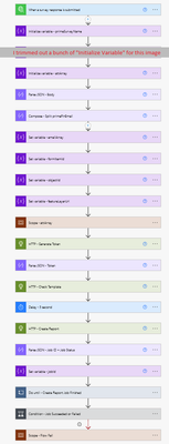

No worries! It can be confusing.
What I have posted above is one single flow* and all the steps, including "Add an HTTP" steps, are included in that flow under a single trigger.
*I actually recommend splitting this one flow up into two flows. I will likely start a new thread on this soonish.
My full flow looks something like this. Please note that this is NOT the flow I have posted above, so don't try to compare this image line-for-line with the above steps as there may be a couple small variations. I just wanted to show a screen cap of the full flow which includes the HTTP steps.
The "Add an HTTP" step I am referencing above is this:
Does that help at all?
ISP_graynic
Thank you very much! I was trying to add the Http "Trigger" rather than the Http "Action" which was throwing off my flow. I only saw it under the Triggers list earlier but now if I scroll way down I see it as an Action option also. Thanks again for creating this. It would be great if ESRI was able to get the feature report flow added to Automate like the one that exists within Integromat.
