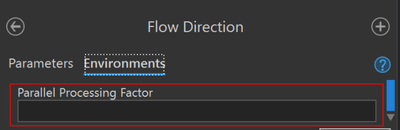

Could you try setting the Parallel Processing Factor (Tool Environments) to 0 (zero), and run the tool again?

It worked. At first time, I went to "Environments" in the Fill tool window. It did not work. But this time, I went to "Geoprocessing>Environment>Parallel Processing Factor > puting 0"
I really appreciate your help.

Also put the parallel processing factor as 0 (I know I am being stubborn on this point 😐 ).

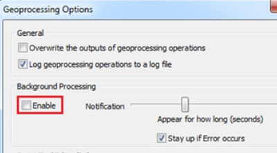

Please ensure the background processing is turned off as well (Geoprocessing > Geoprocessing Options).
I am out of any more ideas. If the issue still persists, maybe log a case with Esri Technical Support.

Hi again Jayanta,
