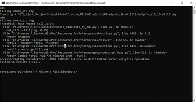

I have the same problem with Fill using Pro 3.2 (python 3.9.16). In my case the script crashed during the 15th iteration. The DEM itself is fine and parametrically identical to the first 14 that worked without any problem. The size of this particular raster is about half of that for one that succeeded.
